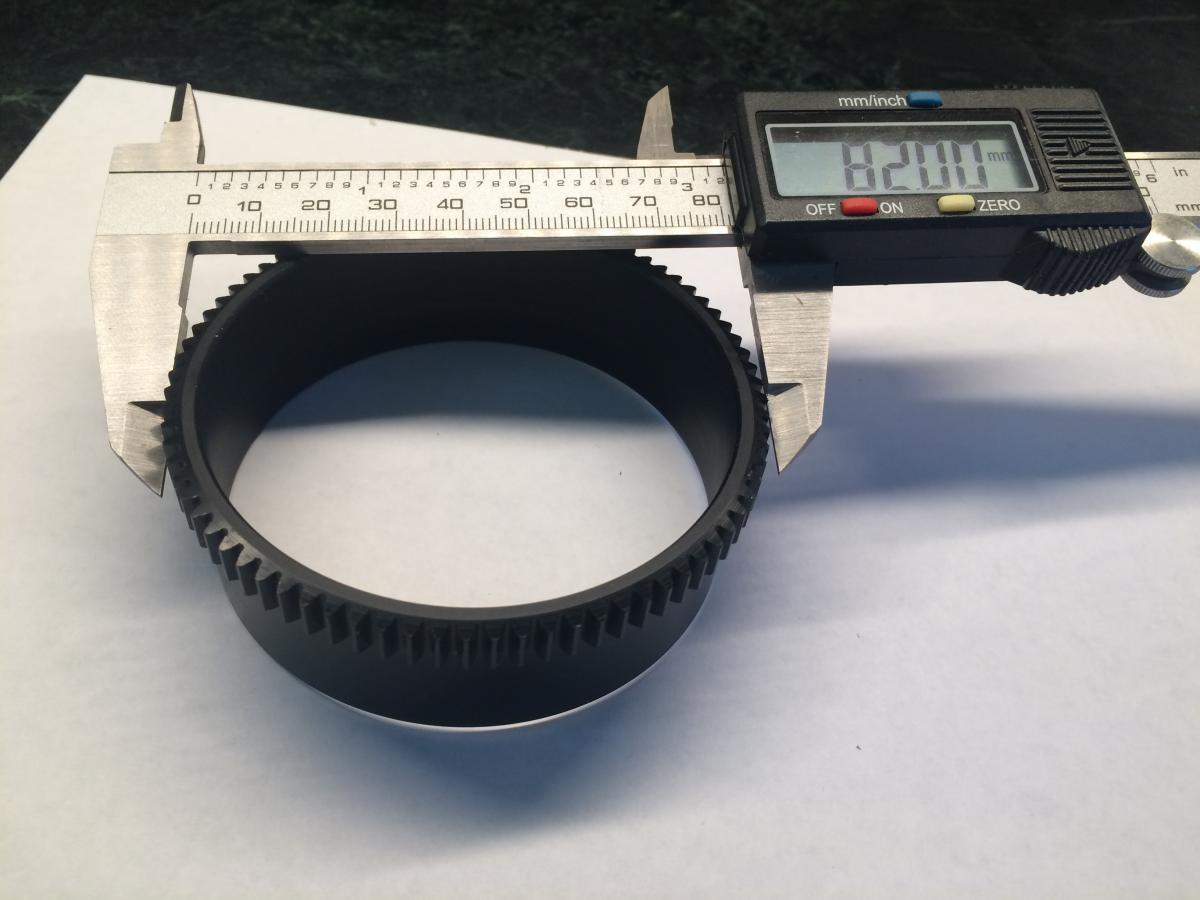

  1. I have a zoom gear and trying to figure what brand housing it fits. The OD of the gear portion is 82mm and has a pretty much the same tooth design as Nauticam and S&S. Subal perhaps??

  3. The gear has no numbers or lettering, does fit my NIK 12-24 DX with rubber zoom ring on. Similar in size to some Anthis/Nexus gears I have laying around.

  5. It's really hard to say but it does look like a Subal zoom ring
  6. Thank you Tim, I have S&S, Nauticam and some Nexus gears but the OD does not match (except maybe Nexus). Just want to move it along to someone who can use it. Fits my 12-24 Nik perfectly.

  9. It's Subal zoom gear for 14-24 lens. Its have 80 gears and it's fits for housing and port that have bayonet type 3.
  10. Thank you Valadimir, 80 teeth. Fits a 12-24 Nik that I have also.
    Steve
  11. It's Subal zoom gear for 14-24 lens. Its have 80 gears and it's fits for housing and port that have bayonet type 3.
    You wouldn't know the Subal part number by chance?
    Steve
  12. 4ZN327
