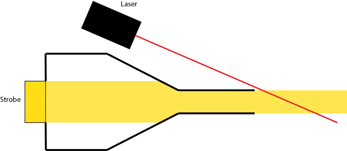

    Their design has the laser unit "riding" on the snoot, and the user has an adjustable knob to adjust the angle of the laser. This means that the beam intersect the actual snoot output path only on one point. Elsewhere it will be off center (and probably off target in the thin version of the snoot).

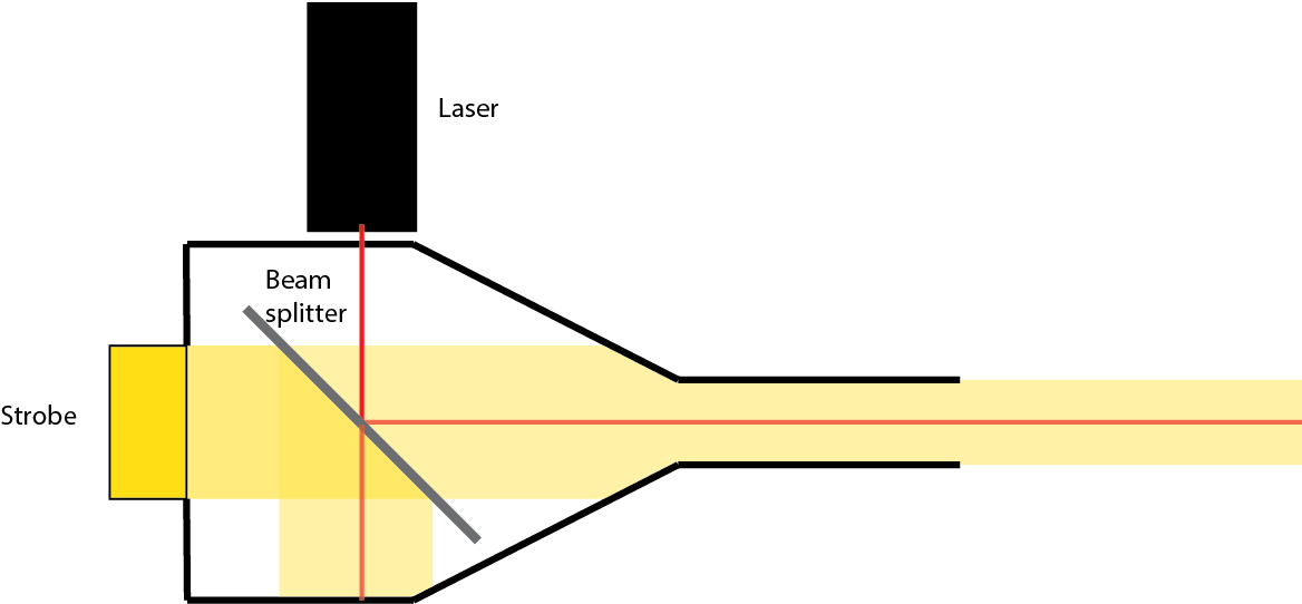

    An ideal solution for this would have the laser run through the center of the snoot, this will make it precise at any distance. I knew similar solution from microscopes using beam splitter. The idea is simple. A beam splitter is half-mirror, where 50% of the light pass through it and 50% bounce off. In this design the laser is positioned perpendicular to the strobe. The beam splitter is setup at 45degrees to both beams.
    The price of this solution is reduction in 1/2 of both the laser beam and the strobe light. Since this setup is used for close macro situation, I reasoned that this will not be a big problem.

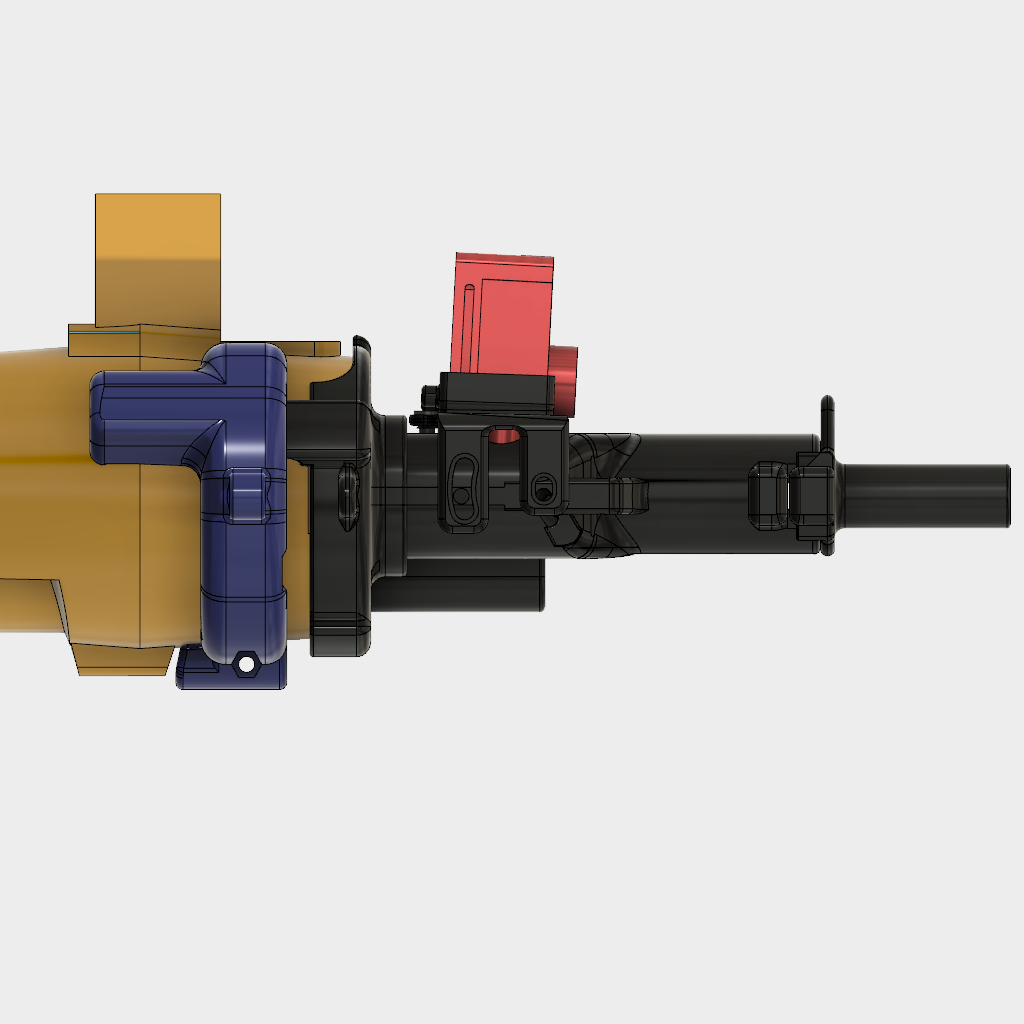

    The final design in my CAD visualization:
    The yellow object is YS-01 strobe. The blue ring is attached to the strobe and allows quick attachment of the snoot. The red box is the laser. The tip at the end is exchangeable and is held in place by magnets. (I did not take a proper picture of the snoot, but can load one later on)
