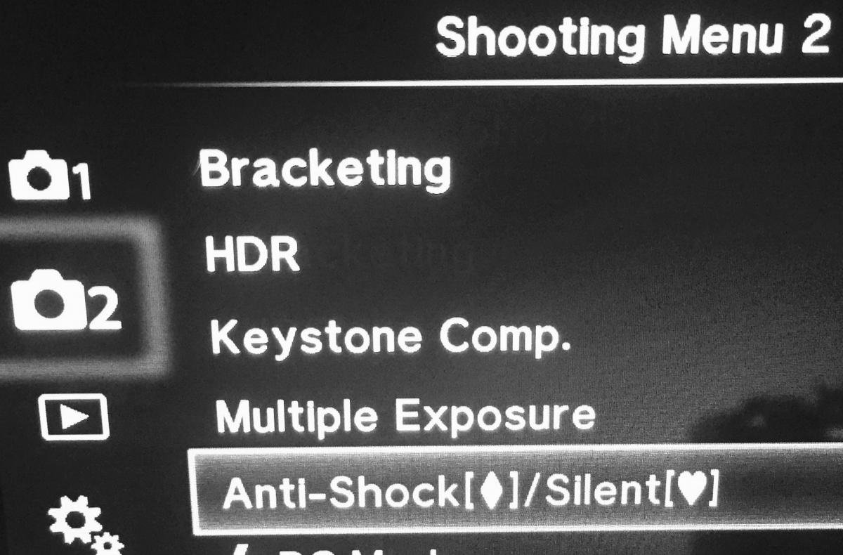

  4. Check you haven't put the shutter into Silent (electronic) mode as the flash won't work in electronic shutter mode.
    The EM1's menus are a bit complex and changing a setting by accident in the super control screen is easy done.
    Edited by Griff
  5. Make sure shutter is not in electronic silent mode here.
  6. Thanks for the tip Griff but that was not the problem.
