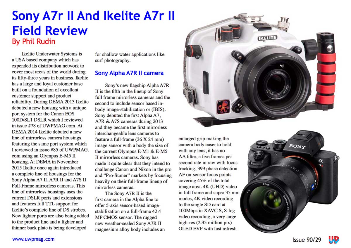

  2. All of the issues you have pointed out were addressed in my review of the Ikelite A7R II housing in the current issue of uwpmag.com along with a few others like lack of a back focus (thumb control) for rear AF. The TTL to manual can be switched on the strobe so I don't see that as a major issue. Regarding the pickup finder I don't think you will find any A7R II housing that has a pickup finder that will do justice to the outstanding EVF on this camera, it is quite large and the pickup finders just does not see all the way into the corners. The housing is equipped with the standard finder found in all Ikelite DSLR housings so I would not expect Ikelite to design a new finder just for this housing when you have a replacement option which as you have pointed out adds an additional cost to the system.
    You may want to look over my review because it addresses some other positive issues as well. An E-mail to Ikelite should resolve your issue over the Canon Fisheye as to port extension length. I used the Rokinon 12mm fisheye for Sony Full Frame so I think Ikelite will be able to give you some direction on that issue.
    uwpmag.com is a free PDF download during the issue cycle.
