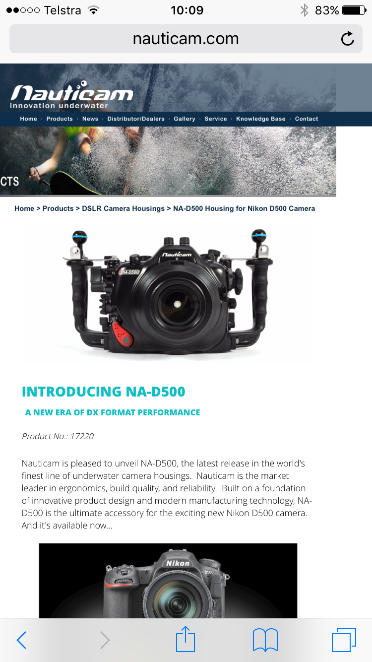

  1. Nauticam have released the NA-D500 which has a built in TTL optical flash converter.
  2. The standard LED flash trigger that ships in these housings is manual only.
    An accessory part, #26307, TTL Converter for Nikon (Compatible with NA-D5/D500, Sea & Sea YS-D and Inon Strobes), $430 is available to add TTL functionality with Sea & Sea YS-D1, YS-D2, Inon D-2000, S-2000, Z-240.
    Future revisions or iterations of that part are planned to support Sea & Sea YS-250, and Ikelite DS-160/DS-161.
    The TTL Converter supports both optical and electrical triggering. With the currently compatible flashes, we recommend optical triggering for the best performance and accuracy. YS-250 and DS-160 don't have optical/slave TTL functionality, so they'll require electrical triggering.
