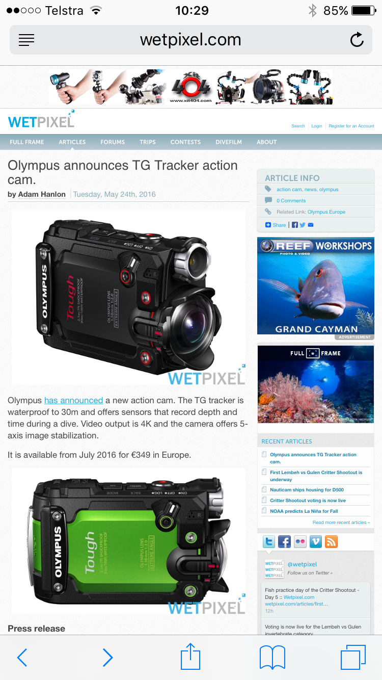

  1. Olympus finally offer 4K and addresses GoPro failings such as terrible battery life, no stabilization, tiny screen, no WB, etc etc. Also waterproof to 30m. Should be worth a look.
  2. Filter?
  3. Automatically switches to underwater mode below 50cm and has a flat lens cover which could take filters. I have the OMD EM1 and its underwater WB mode is pretty good even in video mode.
  4. Let see how it perform at 15-20m
  5. At 15-20 will need lights, like all of them...
