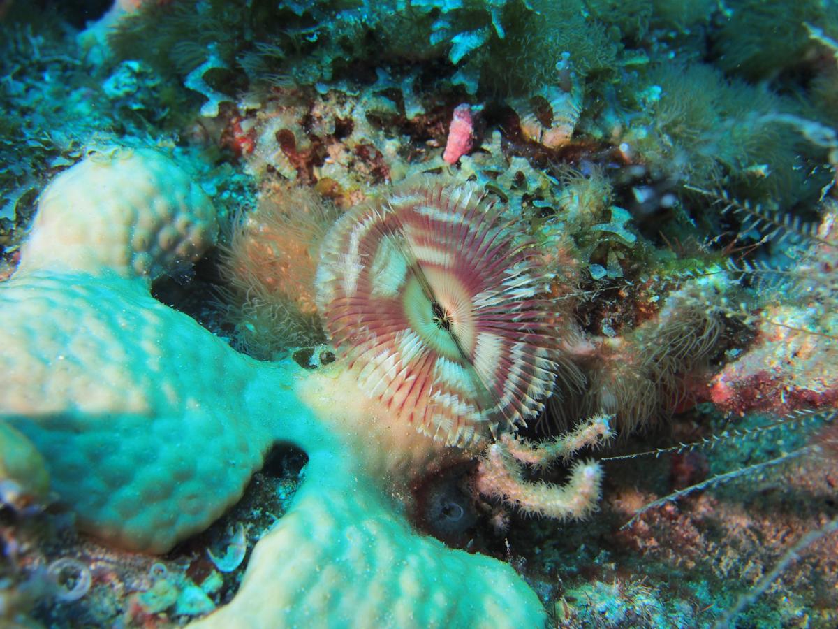

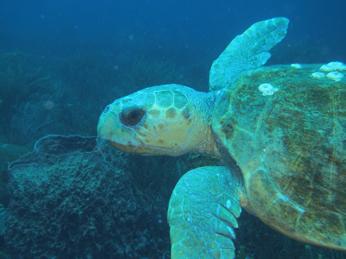

  1. I've been shooting with my EM5 and Inon 2000 strobes...photos constantly come out green. Camera settings are auto WB, ISO 250, f45.5-5.6, shutter 125-160, natural (not vivid). Strobes on manual, full, magnets removed. VERY frustrated, got better pics with my old point /shoot! Any and all suggestions welcome!!
  2. If on manual, magnets need to be in. This cancels the pre-flash. Adam

    - If that turtle was about a meter away, a shutter of 1/160 and aperture of f8 with strobes on sTTL would give a very pleasing foreground exposure with a deep blue background.
    - The feather duster worm is a different story. if you were within say 1/3 of a meter, 1/160 and just about any aperture would allow sTTL to light the whole frame quite evenly, assuming your strobes are aimed correctly.
    But on both shots I have a question: in the turtle image I see some backscatter and in the feather image on the far left it almost looks like a strobe did fire but was aimed out of the frame. Both could be indications that your strobes are firing, but aimed too wide. Or maybe your are zooming in with the lens but keeping at a distance too far for the strobes to work effectively (i.e. anything over a meter). Forgive me if this assumption is off the mark.
    Regardless, you can check your settings at home. Take a shot facing a mirror. if you can see the strobe firing in the resulting image, they are in snyc. If not, try Adam's suggestion. I'd also recommend experimenting with sTTL with a table top subject. By the way, for sTTL your camera flash needs to be set to "Fill" while for manual you can set it to 1/64 power.

  5. It looks like you are not getting any strobe light to the subject. With the same camera and strobes I shoot at 1/250 shutter, f:11 or f:16 and the strobes on manual (with magnets in). If you turn off your strobes I think you will get the same photos, but this can easily be checked at home on the kitchen table. With strobes off photos should be mostly just black, with strobes on they should be well lit.
