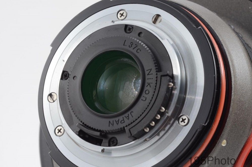

  1. Does anyone know of a repair facility that could clean, and repair the coating on the rear element of this lens. Or better yet replace it.
    May be corrosion of the coating or less likely fungus. It's not on the L37C filter
    Its in otherwise excellent condition.

    I have sent this off to Harald Hordosch at Seacam and they will look at this while doing the Seacam conversion.
    The other thought I have after looking at the patent drawings is that this could represent failure of the lens cement due to cleaning solution leaking between the layers.
    Apparently the glued elements can be separated, cleaned and re-cemented. I will post the outcome when the lens returns from the spa.

    I would put trying to remove damaged lens coating towards the bottom of the list of possible repairs. Using a solvent to remove the coating would be preferable to abrading it off but to use a lens coating solvent would probably entail disassembly of the lens. Not a casual action. This lens is more complex than most interchangeable lens. There is the water sealing to be dealt with.
    Since Nikon doesn't appear interested in doing a repair his options are somewhat limited. They would be.
    Replacement of lens
    Finding someone with sufficient skills and parts to repair the lens and especially the waterproofing
    Removal of whatever the discolouration of the rear element is
    Using the lens as is
    Disassembly and selling as parts
    Finding a garbage can.
    Having, years ago, worked in a camera repair shop, I have seen others do this type of work. Always on a last hope basis. And that repair shop shut down this month. Retirement of owner.

    The lens was purchased fro Japan. It was described as having "some moisture."
    Turns out the original problem was separation of the two rear elements due to a crack in the glass!
    I sent this to Focal Point Lens Repair in Superior Colorado. John Van Stelten was able to disassemble the lens, but on heating to separate the elements, the front element cracked. (He had told me ahead of time this was a 10% risk.)
    All this rendered the lens useless... but to the rescue came Rene Aumann in Salz Germany.
    He was able to provide the element group in its mount, in perfect condition. At a reasonable price too. It must be the only spare part on earth.
    So now all is good:)
    The lens was modified by Harald Hordosch at Seacam, and I am using it on a Nauticam D800 housing with a Nauticam - Seacam port adapter. The combination works perfectly!
