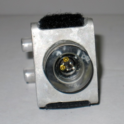

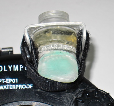

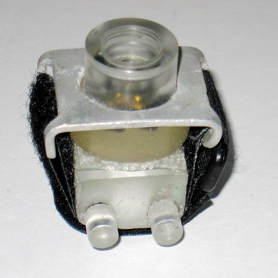

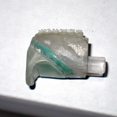

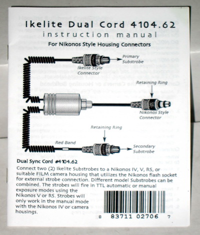

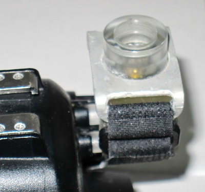

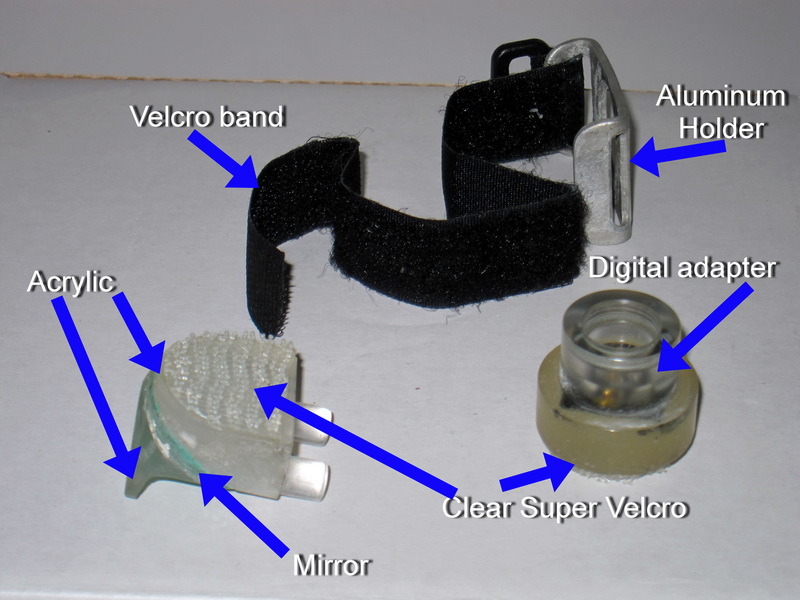

    I guess you need some help. My advice would be to buy ttl fiber optic strobes but here is a alternative solution. I made this part to hook up two ikelite ds-51 strobes and use them in ttl mode with the olympus housing. You will need a digital adapter and a new strobe cord as well as the part that I made for my system. I think the pictures will explain a lot.
    Here is a link to the digital adapter: http://www.heinrichsweikamp.com/?id=34

    I hope this helps.
