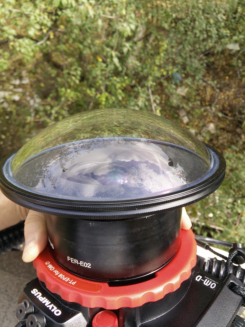

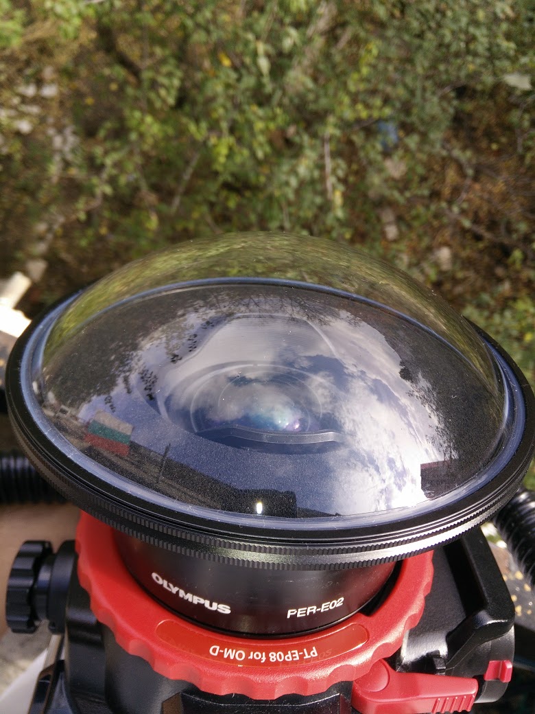

    I found PER-02 for cheap in ebay, since on the most places it is deprecated product. Here how it looks on 7mm and 14mm focal length with the 170mm Inon dome:

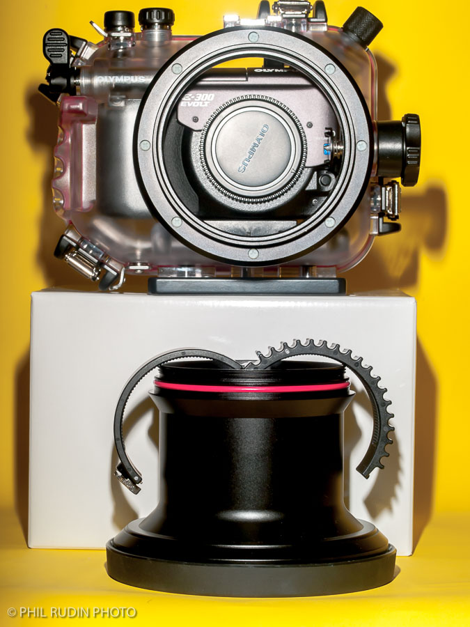

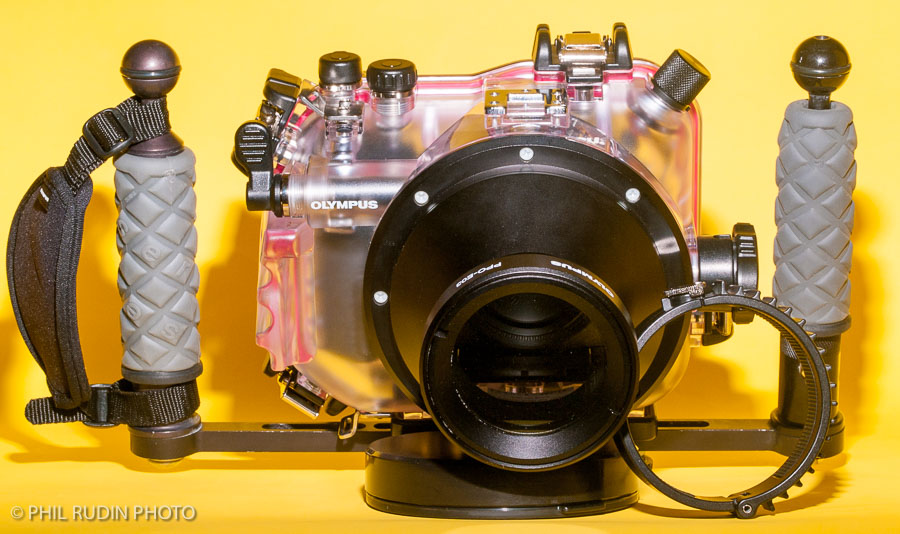

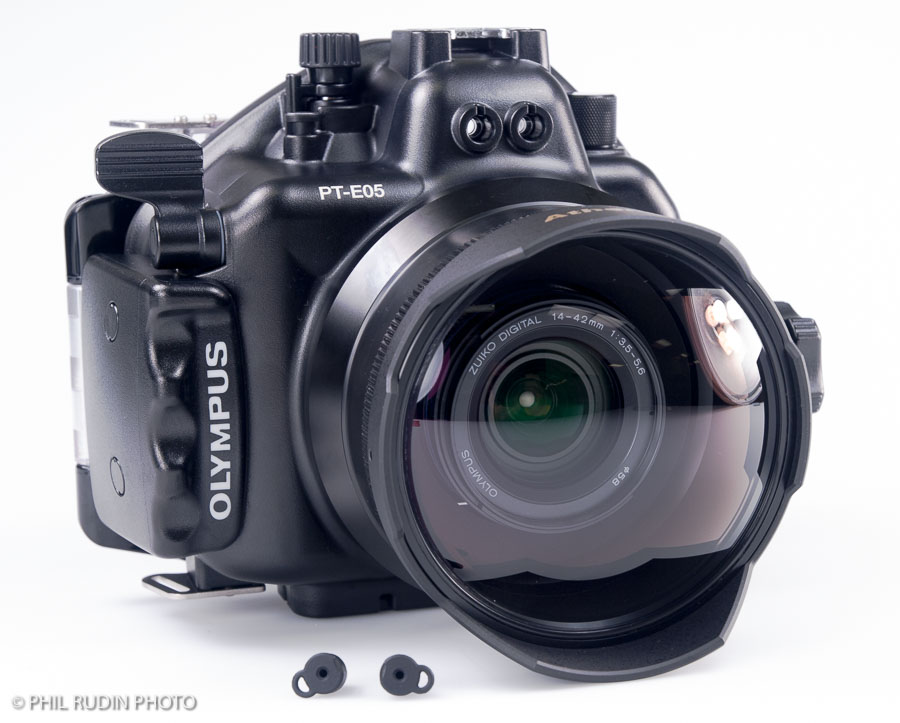

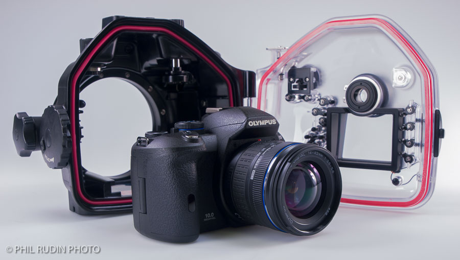

  17. The Olympus PPO-EO1-EO5 ports, the PER-EO2 extension and several gears are carry overs from the Olympus 4/3 format DSLR underwater housings. This is the reason you need the threaded port adapter for them to work with the PT-EP housing line rather than just pushing in like the newer ports designed for M43 PT-EP housings.
    Ports were also made by Athena, Inon and others for the DSLR line of housings. Olympus is the only camera manufacture that has consistently released housings for their interchangeably lens auto focus housing going all the way back to the E-300.
    I have included photos of the Olympus E-300 and E-520 housings with some of these ports.
