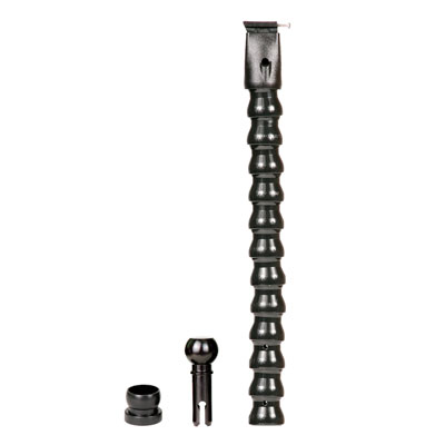

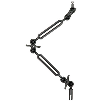

  1. i am planning on wide angle shoot with tokina 10-17mm
    and wonder about ikelite housing for those who used them
    they are offering different arms for the DS51
    one of them is flex arm and the other is double 7" arms ?
    is there a difference when using tokina 10-17mm
    or the flex arm will work great with it ?
    or i have to get the double arm ?
  2. The double arm will give more distance from the camera for strobe placement, so you can light subjects further away. For closer subjects, it will matter less. Flex/squeaky arms vs ball arms is a matter of personal preference. Have a look at the strobe arm length pinned thread in the lighting forum.

  6. If you are using the DS51 the flex arm should be ok but heavier strobes such as the DS125 or 160 might be an issue as the weight of them will cause the flex arm to move especially if diving in a current. As Gerard said the DS51 will certainly be more for CFWA. I doubt you could light a diver in the water like the picture you have attached, not as evenly anyway. I use 2 InonZ240's with my ikelite housing and tokina 10-17mm (i shoot manual as no TTL functionally with inons) and these are very effective.
