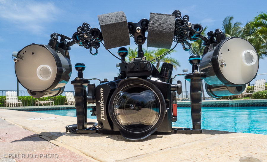

    - Assembling the rig with the Olympus 7-14mm frankly sounds like a nightmare. Because of the lens' size, it can only fit through the front of the housing. So to even change the camera battery, you have to take off the port and extensions, remove the lens from the front, then open the housing and finally take the camera out through the back. To me that sounds like you've just doubled the chances of having a catastrophic flood. Is this as big a deal as I fear?

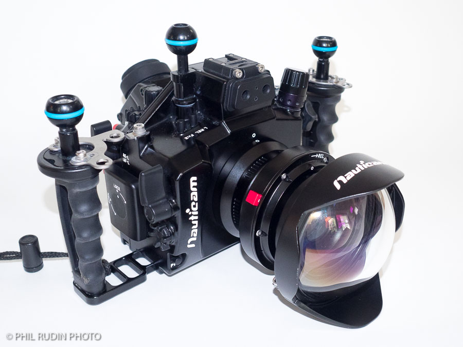

  5. Regarding CFWA and WAM photography much has to do with the size of the port since both the Olympus 8mm Fisheye and the Olympus 7-14mm zoom will focus all the way to the port glass. The difference is that one is a 100mm port and the other is 170 or 180mm. See attached photos of the Zen 100mm and the Zen Underwater 170mm ports. The Conch is a CFWA using the 170mm port and the anomie is with the 100mm port.
    You may also want to consider the Nauticam WWL-1 water contact lens which can be more cost effective, it works with M43 "kit" zooms from both Olympus and Panasonic in a small flat port with 67mm thread. It can be removed U/W and replaced with a closeup lens like the Nauticam CMC-1 & CMC-2, also linked a photo.

    I added up the cost of the Panasonic 7-14 + Nauticam's acrylic 6" port, vs the Olympus 7-14 + adapter + glass 180mm port... and the Olympus came out at more than double the price! Add in the inconvenient size of the Olympus, and in the end it was a no-brainer.
    So Panasonic 7-14, here I come! Cheers again for the advice - I'll post up the results as soon as I get something that's not too awful. ;-)

  12. Olympus OMD housings with the quick change port system do not require port removal to install or remove the camera + 7-14 lens.
  13. Interesting discussio here...
    I have a question regarding the problem with assembly of camera+Olympus 7-14mm with the housing: Does this problem also apply for the Olympus housings (with exchangable domes), or only to the Nauticam housings?
    Wolfgang
    As you know the lens is to wide for the N85 port system from Nauticam.
    Olympus original housings have had different port solutions. Some are wide enough.
