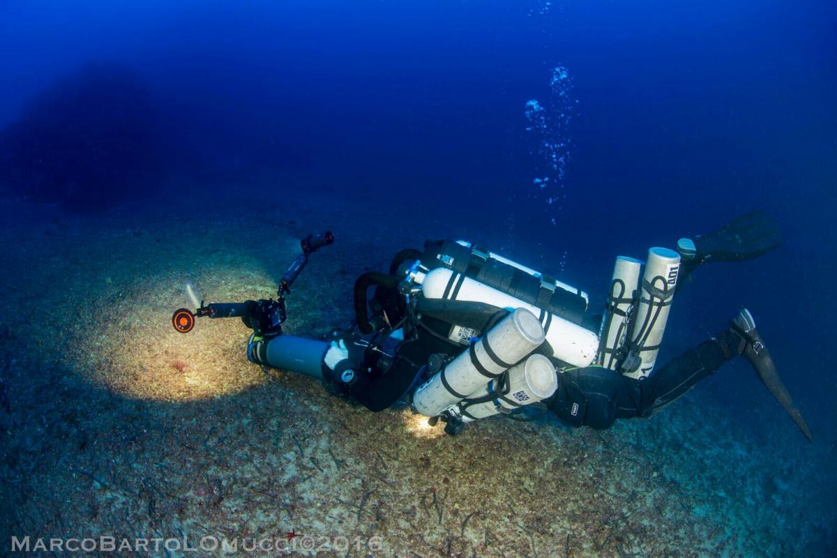

  5. I cannot bring with me a large tripod because I need a scooter to get there. Usually for my wa shots I mount everything on the scooter. I could bring something like a gorillapod or a very cheap tripod as disposable. I have to minimize efforts while operating at depth.
    Luftu thank you for your offer. Which lens did you use for those shots? Is it the GH4?Unfortunately a trip to Turkey is out of budget right now. It's incredible that the same animal is so shallow there. I think it depends on water viz. Here water it's so clear that they live at 60+ meters. Insee the same kind of sea bottom. I know that the even Funiculina lies at 20m in north UK.
    Those two species used to be very common but bottom trawling has completely destroyed most of them. New studies prove that in pristine habitat these kind of animals are nursery for whitebait schools hence very important for fish stocks (and fisheries).
    This is me while filming Veretillum at 70+ m in Tuscany.
  6. That scooter is fat enough to act as your tripod unless you specifically want shots of the top of the sea pen. Lay it down and if it won't settle in a stable position, weigh it down or wedge a rock or something under the side of it. Set the front of the port about 30cm from the polyps and start there. Do an auto focus then lock focus and ease the whole rig forwards or backwards for fine adjustment if you need to. Even lighting from each side will tend to make the subject flat. I would try with one light from the front and one from the side, but you may well get a more pleasing shot with just one light either from the side or from directly above, so after the shot with 2 lights, you can simply turn one on at a time. Try and get the lens's aperture "somewhere in the middle" of the range. Avoid very small aperture which will soften the image. If you follow your camera's exposure, this may well make the subject a little overexposed since it will be bright, relatively small subject against a darker background. This is a mistake I often make. If anything, drop the exposure down a little from what the camera says is correct. Perhaps try a shot with auto white balance and one with a manual white balance suitable for your lights' colour temperature, unless you're already confident in which will work best. Let the shots run long enough to remove the wobbles in post-production and to let any sediment settle down.
  7. That scooter is fat enough to act as your tripod unless you specifically want shots of the top of the sea pen. Lay it down and if it won't settle in a stable position, weigh it down or wedge a rock or something under the side of it.
    Thanks Nick. Good suggestions
    I hope the scooter will be high enough to reach the polyps of the Funiculina. Moreover the sea bottom is mostly mud down there Regarding exposure, you are right. Even for WA I ruined several shots relying on the camera exposure filming animals like these. They reflect lights like a road sign!
