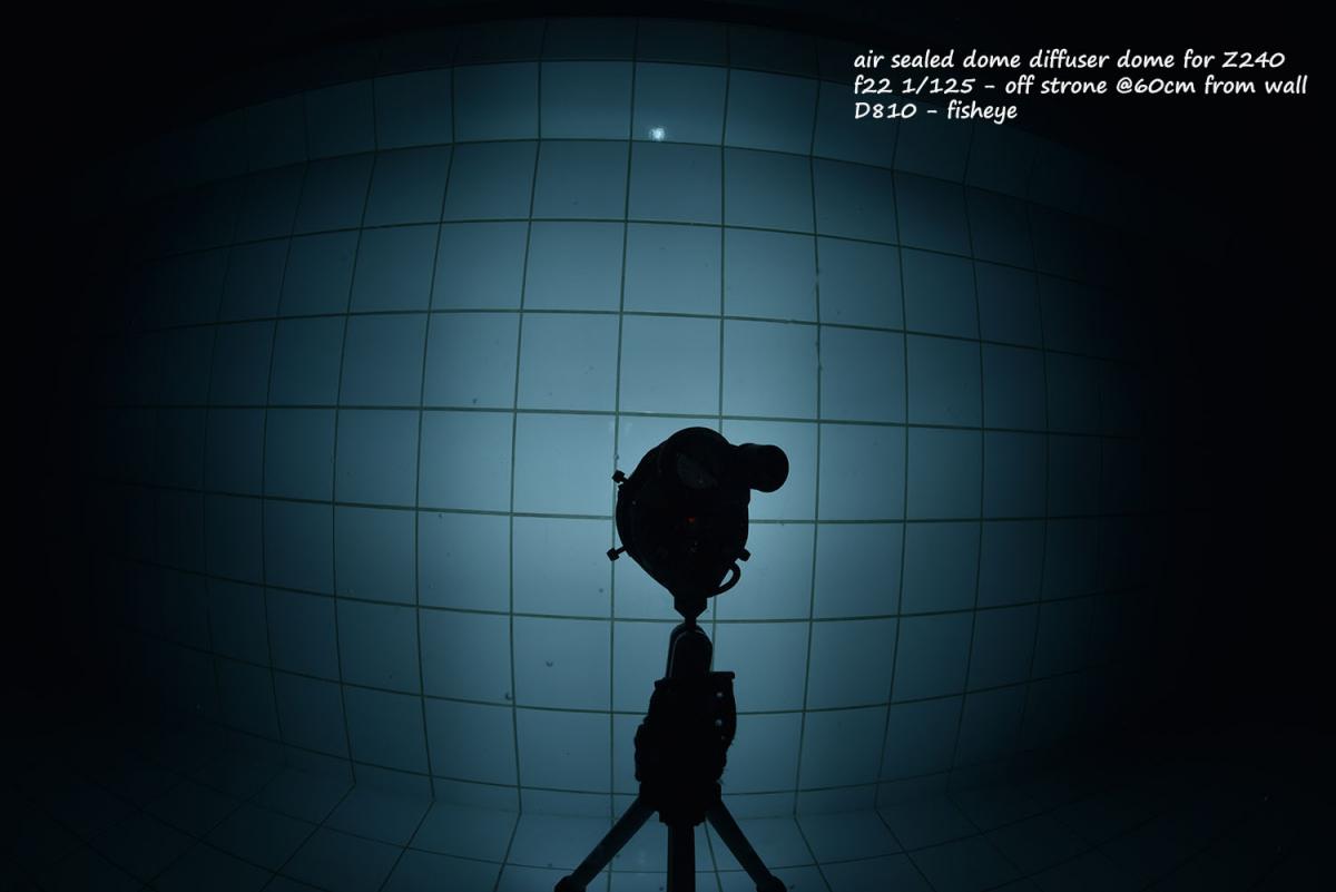

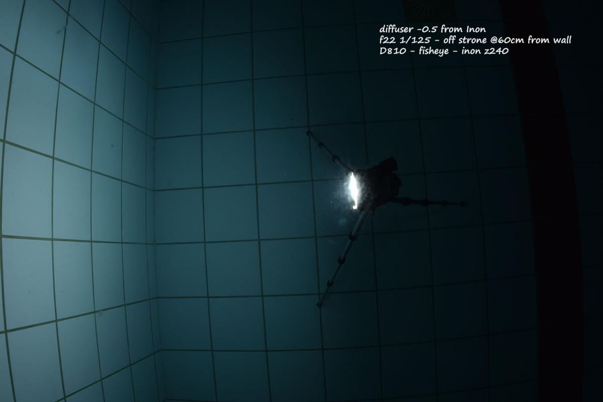

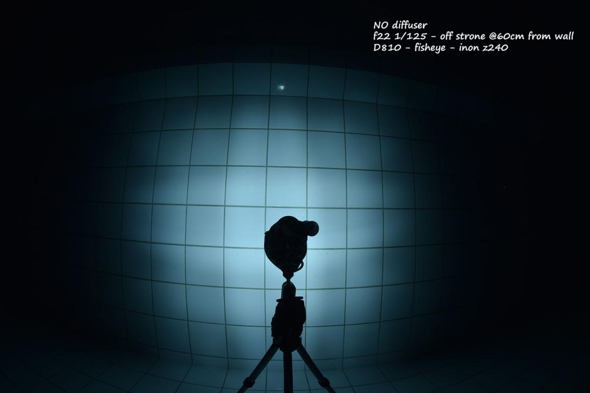

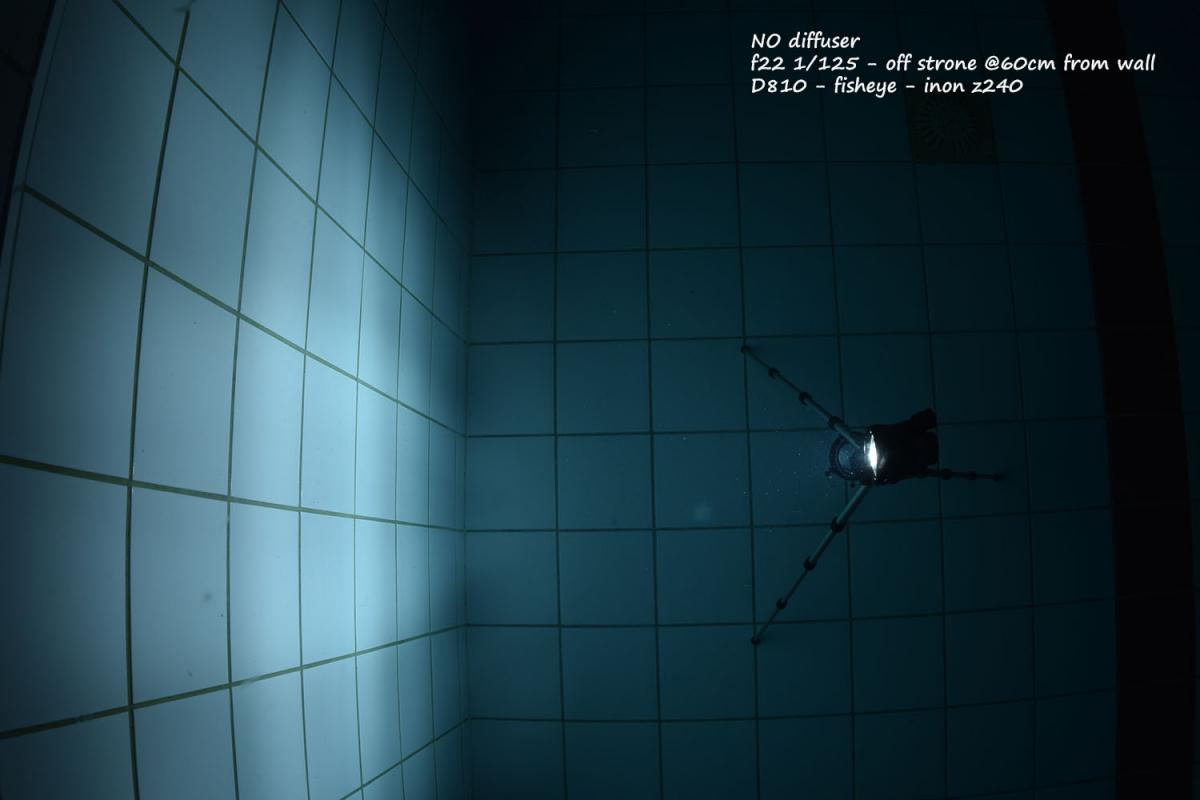

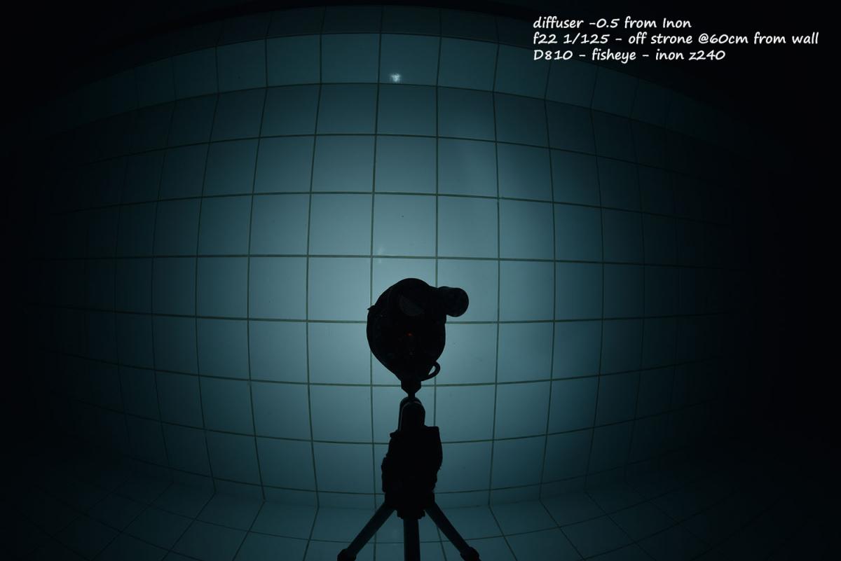

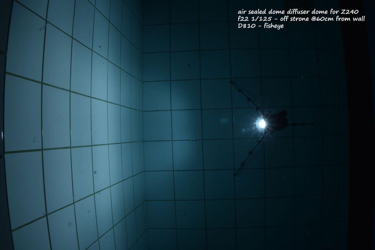

  7. My opinion .. the air filled diffuser is the widest and softer, no loss of strobe light.
    Pics are not edited!
    Grts, Hedwig.
    strone = strobe :P
    1 tile = 20cm
    post-11074-0-92213700-1482936910_thumb.jpg post-11074-0-21497100-1482936913_thumb.jpgpost-11074-0-32758400-1482936915_thumb.jpg
    post-11074-0-13765800-1482936912_thumb.jpgpost-11074-0-31569600-1482936914_thumb.jpgpost-11074-0-41609300-1482936916_thumb.jpg

  8. Dear Hedwig, thanks for sharing your test results. How about user-friendliness of this air-filled diffuser? Does it attach easily to your Z240 and maintain a good air seal?
  9. the air filled dome is seperate filled with air and sealed. There is a gap from 3mm between the strobe and diffuser that is filled with water. installing the diffuser is very easy and stable ... fixation with 4 screws in pvc.
    Verstuurd vanaf mijn GT-I9505 met Tapatalk

  11. great comparison - thanks for the effort!
    air diffuser really looks brighter...but is it me or one can see the "cross ribs" i.e. as inon flash tubes are arranged in a T shape?
  12. yes ... you can see the T shape without diffuser ... thats why i like strobes with ring flash tubes
  13. yes ... you can see the T shape without diffuser ... thats why i like strobes with ring flash tubes
    hah but its also visible with the air diffuser a bit...hmm undecided, it does look brighter but also a bit uneven, especially on the side shots.
  14. The quality of the soft light from the dome diffuser is beautiful - something that would get portrait photographers excited.
    It also has a much better spread and it appears a higher color temperature than the flat diffuser.
    Thanks for this owfotograaf, it will come in handy in the future.
