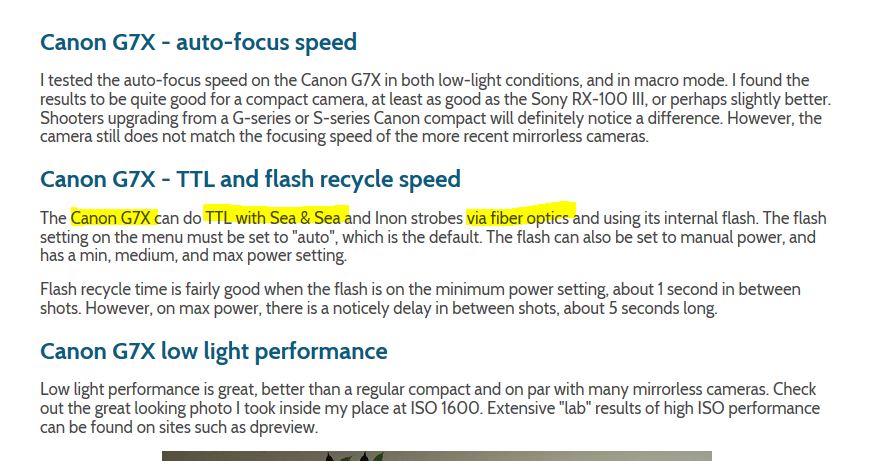

  2. Hello Andreas,
    thanks a lot for your reply!

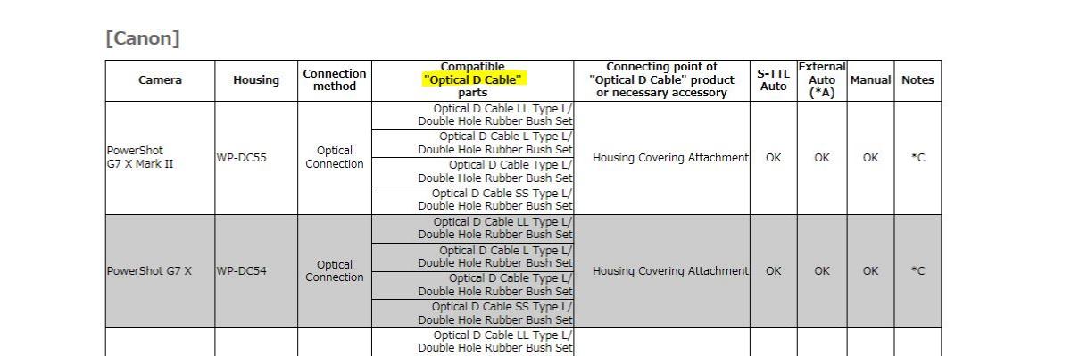

    I was hoping to save some money at the beginning and try not to buy optical cables. I wanted to divest on underwater photography equipment and went for a Meikon housing, and honestly I don't know which cables are compatible with it (optical D-cable type L or LL for the flash, but I don't know the housing endpoint).
    From this chart, it looks like the two should be working also wirelessly:
    http://www.inon.jp/products/strobe/optical/wireless.html
    I'll try to do some more tests...
