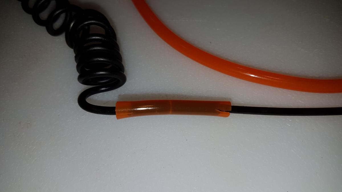

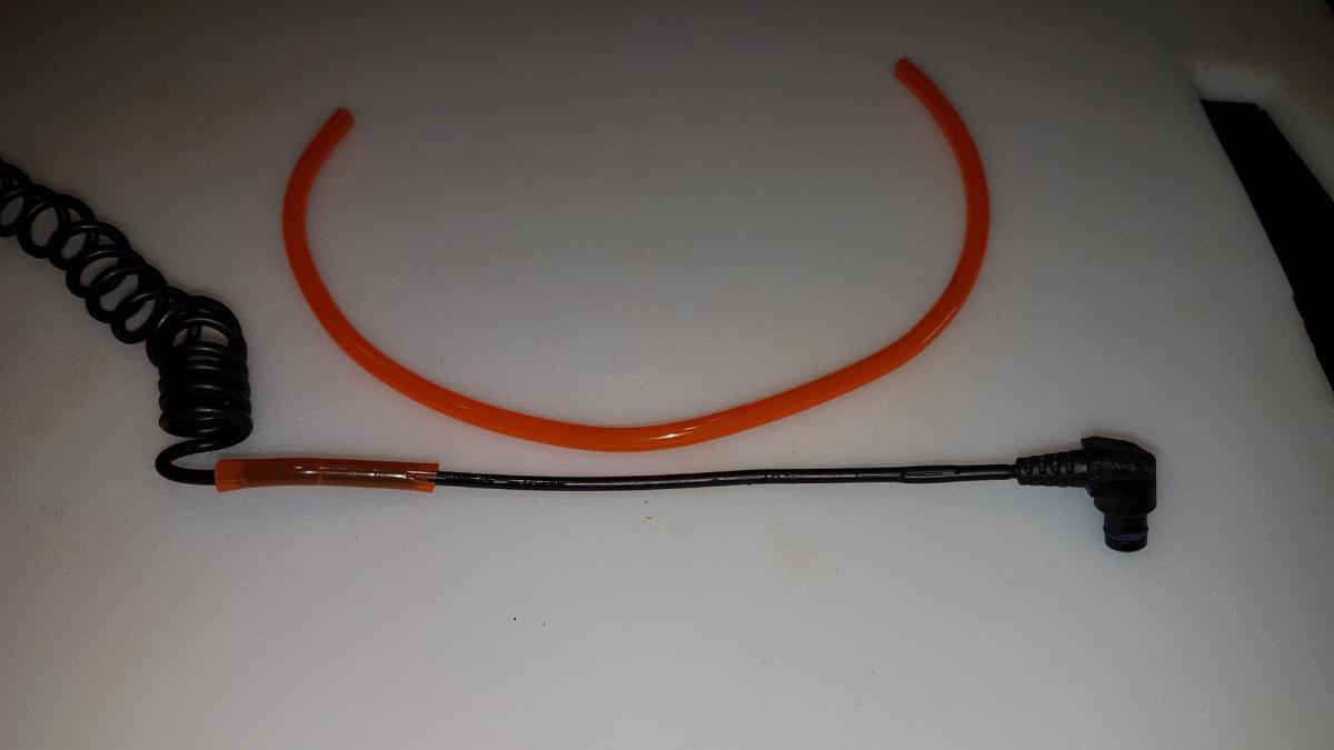

    So for now I managed to find some plastic tubing which is a really tight fit over the fiber cable. I cut both ends of the fiber with a very sharp cutter, and then cut a small length of the tubing put a small incision in both ends and using WD40 as a lubricant pushed both fibers into the tubing until they met, finally I used super glue to seal both ends of the tubing. I've tested on the surface and it seems to work OK, tomorrow I will take it in the water and keep my fingers crossed that it keeps working!

  6. That looks like a good solution as long as you can get the light to transfer and keep the cables aligned. if you apply a little heat to the tubing it would be possible to straiten it out perfectly.
