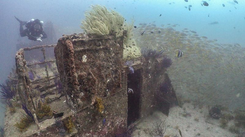

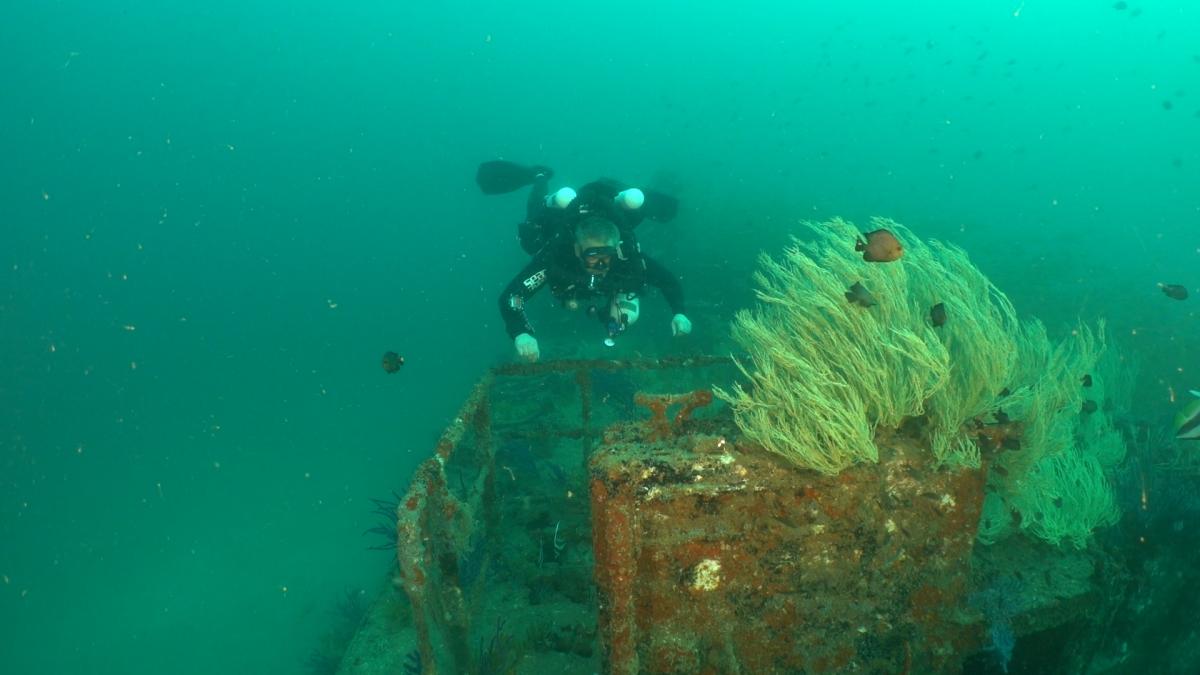

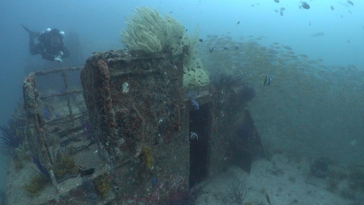

  6. This is what i mean
    Photo is grab frame from footage shot on Sony RX100 Mk4. One push white balance no lights depth is 19m.
    Second photo is the same wreck same day same camera Auto WB. Yes i am using lights in this one but i am not so close to affect so much. What i can tell you is that the second photo is much much closer to what the condition was really like on the dive. May be a little less green than in the photo but for sure not what is shown in the first photo.

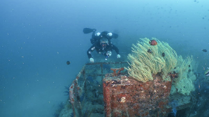

    Your pix are not too bad. I grabbed the jpegs you posted and imported them into Lightroom to do the tweaking. The second shot that you AWB got only a tint adjustment (green-magenta slider) in the way of color balance change from me so color temp may have been OK via AWB. AWB may ONLY do color temp and no tint adjustment - ask Sony not me!!
  10.
    I have no idea how the Sony AWB thinks. The thing is that in my eyes none of the versions represent how it was on the dive. Yes, the one you retouched looks more pleasant to the eye, but still, I would not end up with such a version on the final video.
    To me, the results do not justify the custom WB and all the trouble around it. I think the way forward for me it will be experimenting with fixed white balance values and tint adjustments for deeper dives or when vis is limited.
