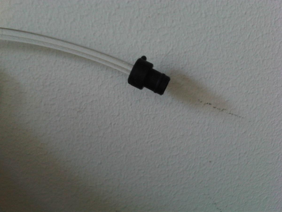

  7. Hi
    I followed the advice of Leidlt and bought some cheap transparent optical cable (endglow). I found the 2.5 mm cable easier to use than the thicker 4mm cable because you can stick it directly in the Bush two hole connector. In a way, the light output is stronger than in the commercial multicore cable. Easy does it! See the picture. For some, a minus point could be that the cable is stiffer than the commercial UWP cables.
