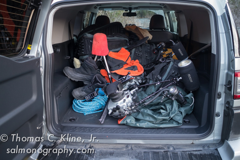

  5. I attach focusing lights to the sides of my ULCS arms by mounting a simple ballhead to the arm while using a large washer for the bolt. The bolt runs through the latticework of the ULCS arms. I found this jpeg on my HD from a couple years ago. It shows my gear after arriving at one of my salmon sites but after putting on my waders (topside shoes in pic). The rig closest to the back of my SUV has a light (Fisheye light) on one of the balls while the other has a Seacam clamp on it but no light. You can see the large washer from the side on the unused side. A similar arrangement would likely also work with Keldans equipped with a standard ball fitting.
    Edited by Tom_Kline
