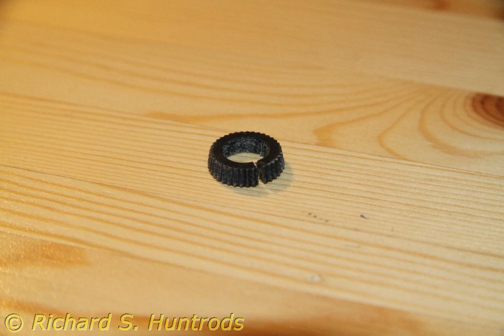

  13. Slightly related question. Today I installed the port and then water tested the housing (large bin full of water). No problems.
    However, when I was done and the housing dry, I found the rubber wheel that fits on the mode controller wheel (sets P, Av, At, M etc) had fallen off the control. Closer look revealed the rubber wheel had a break in it.
    This is a tiny part and I don't see it in parts lists, certainly not from dealers.I'm thinking as it's just a single break and seems otherwise sound I could glue it and just keep using it. How do you all deal with this type of thing?
  14. This is a tiny part and I don't see it in parts lists, certainly not from dealers.I'm thinking as it's just a single break and seems otherwise sound I could glue it and just keep using it. How do you all deal with this type of thing?

  15. Thanks Stoo. I did send Nauticam a photo today with the same questions (glue or replace). Here's the photo...
    Just trying to figure out which glue to use. I'm thinking a very thin smear of 5-min epoxy might be best. I never have any crazy glue around because the tubes always crystallize before the second use (it's usually a long time between when I need it). :-)

    I suspect that the trick with that particular repair is that if the adhesive creates any "thickness" the hole diameter might end up larger than the shaft it presumably sticks on.
    Is it soft rubber, or is it hard plastic? At Home Depot they have a really good "adhesives" display with about two dozen different types with a listing of what each will stick...
    Edited by Stoo
  17. Stoo, that is too cool! I'll have to look for them. It's rubber, but somewhat hard. Not squishy and soft like sponge rubber or neoprene, but more like the consistency of a car tire material.
    Worst case I can always glue it to the shaft. That type of repair is usually pretty easy to remove and clean up later if necessary.
