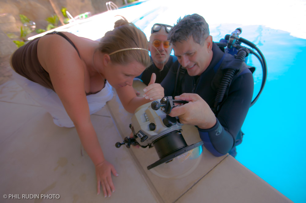

  12. I have owned the Athena 200mm port as well with the threaded Olympus style mount for the 4/3 housings like the Athena housing in the attached photo. This was during an advert shoot in Las Vegas for Turnberry Co. using an Olympus E-3 and Olympus Zuiko 8mm F/3.5 lens. It also worked very well with the Zuiko 7-14 DSLR lens.
