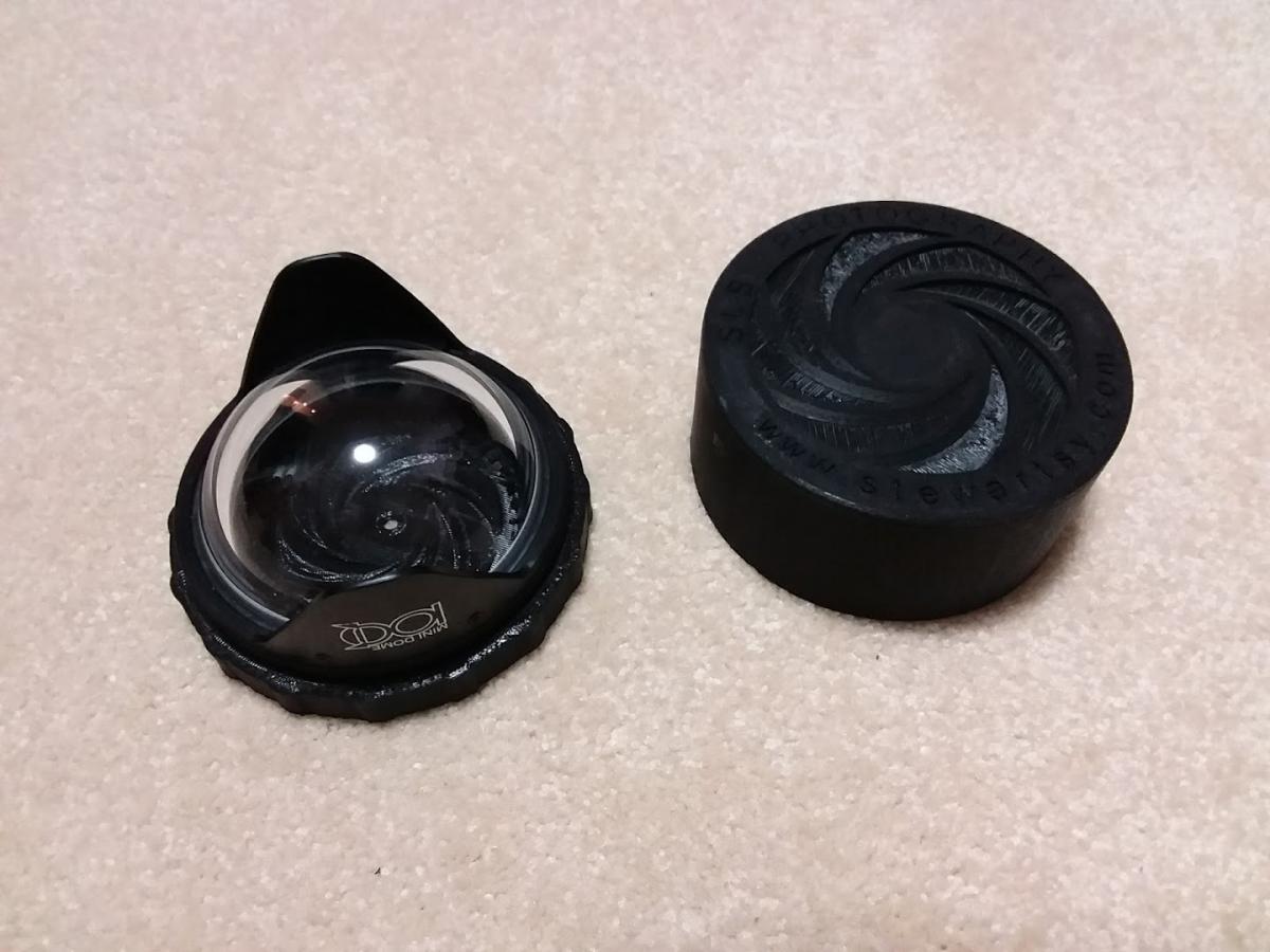

  4. Find a 3D printer service or a friend who has one...also a 3D printed port cap.
    Used the fuzzy part velcro tape on the inside to hold the cover to the dome shade.
    Stu

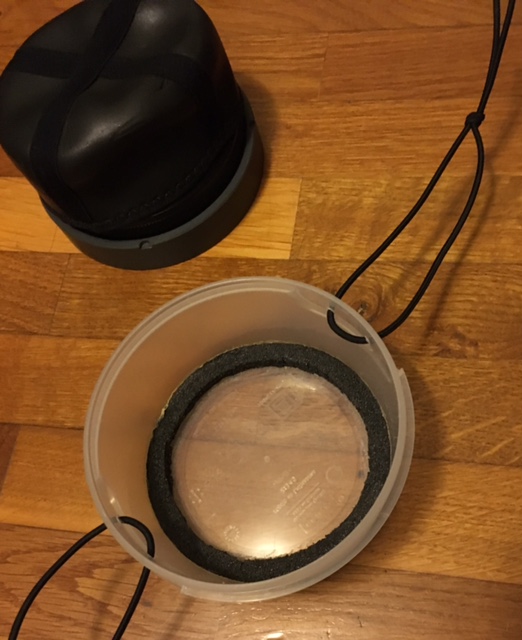

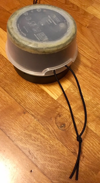

  8. Hi
    Use a solution almost like the one from Matti. But instead a pvc pipe end, I use a Tupperware.
    I took the Port with me to the supermarkets and was trying the ones that would fit better. I found one that fits perfectly, but I added a "ring" of neoprene to the shade be against it, to grant that the box do not touch the glass. 4 litle holes and 2 bungees to hold it in place (one on the zoom gear and the other on the shutter). On the bungees I left a 5 cm tip to be easier to pull out the bungees when the cover is on.
    Front the phone I am not able to attach a photo, I will try to attach it later
  9. Now the pictures....

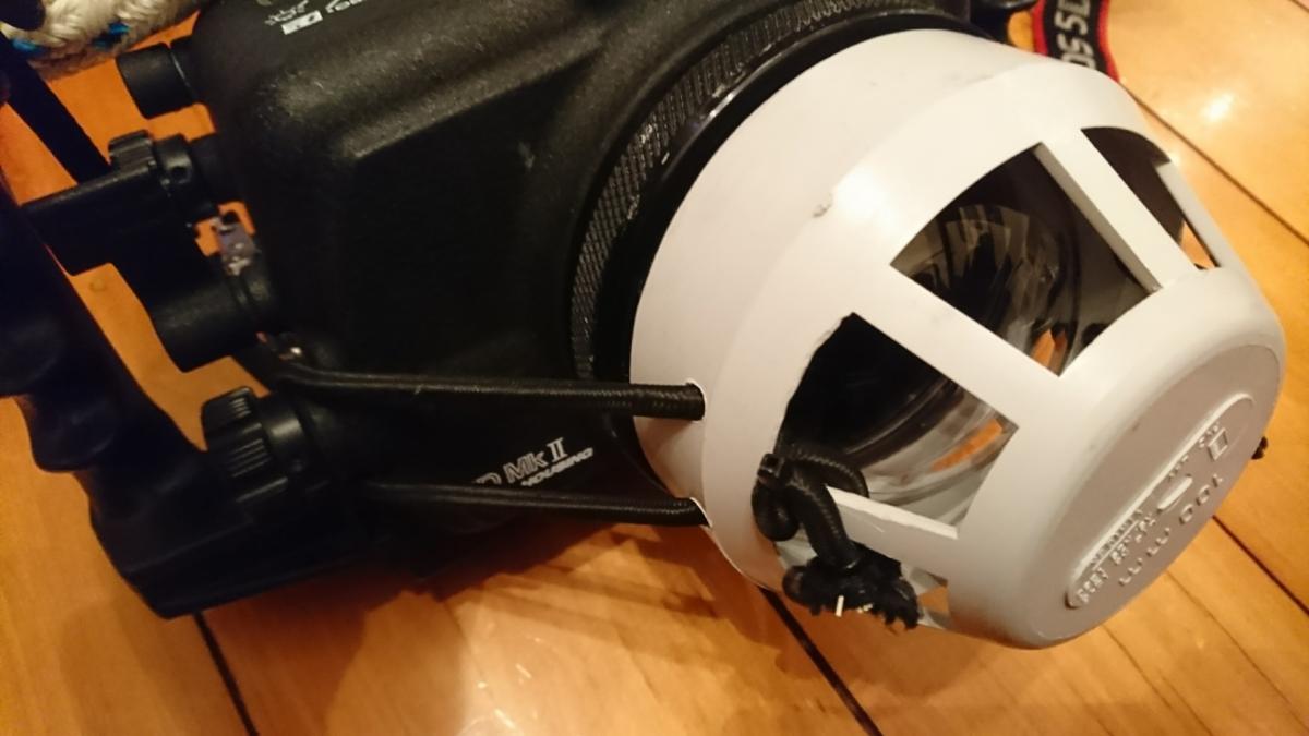

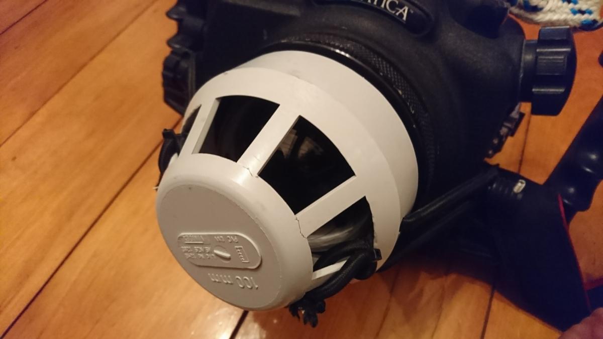

  10. I recently made something similar with a pvc end cap, but I needed a bit more slop so that I could glue in some foam cushioning, so spent a while with a dremel sanding out the inside.. warning, that thick pvc is a nightmare to work with!
    Anyways, this is what I came up with... still haven't added the bungee but was going to do something pretty similar to what Matti did:
