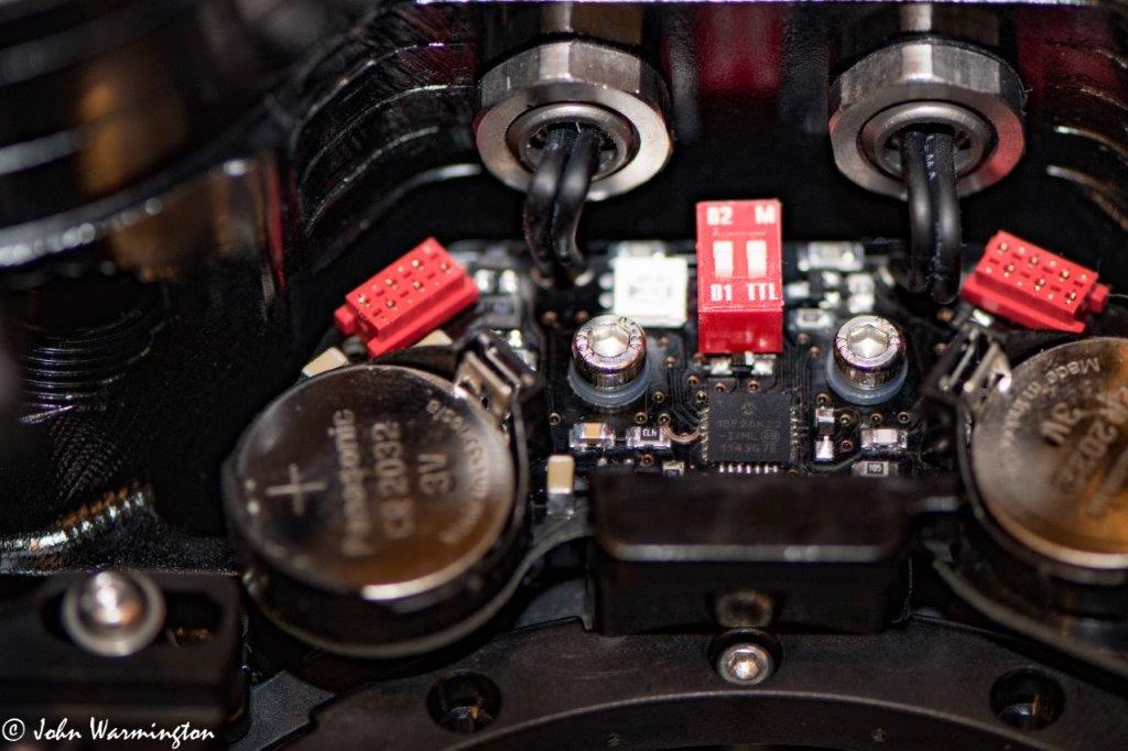

    First of all, please show a photo of installed TTL Converter, to look how are LEDs installed in optical bulkheads. And the photo of your FO cable. What is Nauticam product number for that cable type?, how old is the cable?

  6. .... ACCEPTABLE - DONE AT NIGHT IN LIT ROOM - FOUND THAT STROBE FIRED PERFECTLY - NO MISFIRES AND COULD SHOOT CONTINUOUSLY
    As i see, the test is successful. TTL-Converter works.
    This is #26307 product on the picture. LEDs are installed correctly.

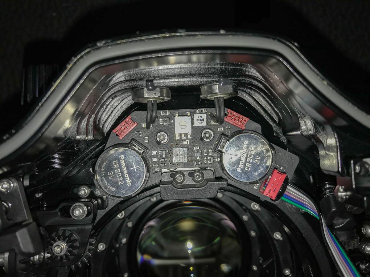

  15. Hi everybody
    I would like to contact you about this discussion because I have some usage problem that resembles JohnVila's.
    I had a set consisting of a Nikon D7000 in a Hugyfot housing with two Inon Z-240 flashes. I said that I had never encountered any problems related to flashes with this configuration.
    Since June of this year, I switched to a Nikon D850 in a Nauticam housing with the same two Inon flashes. I changed when buying the two optical fibers and the original manual card, by a Nauticam TTL card and Nauticam fiber optics.
    In general, like JohnVila, I have the impression that I can not control the power of the flashes with the left selector of the Inon flashes. but especially it seems to me that one of my flashes illuminates almost nothing compared to the other.
    Before performing the different tests listed earlier in the discussion, I would like some precission on the TTL card. When I bought Nauticam Switzerland was out of stock and I had to wait a month and a half to receive it. This card is different from the one I saw in the photo on the web. I am not the selector (red piece) in the center of the card. Is this a new version?
    Thank you in advance for any useful information that could be communicated to me to solve my problem.
    Thanks in advance and sorry for my bad english.
    Edited by bshark39
  16. I can help you.
    Do you have User's Manual for such board? If not, i can send by e-mail.
    In short words, the initial settings are following:
    Rotary switch on board:
    The rotary switch (positions 1....9) on that TTL board is purposed for strobe type select. For Inon Z-240 you must set it to "1" position.
    But on your photo i see that switch at "0" position, which means fixed M mode set by hardware tools. You have to set it to "1", then TTL will work.
    If TTL works normally, it confirms by "green" LED light on the board after each shot. In M mode the LED light is "blue". If battery is low, LED lights "Red'.
    Switching TTL/M by Nikon camera menu:
    Check your camera menu sync speed setting.
    For TTL mode in system you have to set any normal sync speed by your camera menu, for example 1/200 (any speed without "Auto FP" mark). Because "Auto FP" command in that menu is assigned for fast switching electronics to M mode underwater.

  17. I can help you.
    Fiber optical cables:
    Use only new Nauticam #26216 fiber optical cables (613 cores inside), this TTL board is tuned for them.
    Inon Z-240 initial settings:
    Set Z-240 left dial (mode selector) to "S-TTL" position.
    Set Z-240 right dial to "12 o'clock" position, as initial setting. This means zero correction +/-. Later you can use +/- exp.compensation by that right dial, as well as by camera +/- flash exp. compensation.
    Set Z-240 magnet to "down" position (push down and lock).
    Hi Pavel and thank you for your answer which was very helpful.
    Actually with my bad English I did not correctly understand this information on the user manual of the TTL card.
    It works much better like that !
    LED lights up green.
    I programmed the sync speed to 1/200 without the FP. Moreover I tell myself that I should program a custom mode for the underwater photo. That makes me change the camera body program all the time.

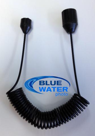

    I think for this point I have a little problem.
    When I bought the whole from my dealer, I asked him the reference # 26221, without knowing that there was a specific reference # 26216, for this type of card. Visibly him either. Is this very important? does it change the management of the information transmitted / received by the camera body and the flashes?

    #26221 is dual cable. If you look into the User's Manual, there written that dual optical cables are not recommended for TTL control with Nautcam housings, because of optical connector construction.
    TTL-converter #26308 currently is calibrated for #26216 cables usage. It is a new single cable with very high transmission index, because of 613 cores inside.
    If you use any other (old) Nauticam single cable, Ok, it will work too, but TTL accuracy will be better using #26216.
    I recommend you to purchase a pair of #26216 cables for your TTL system.

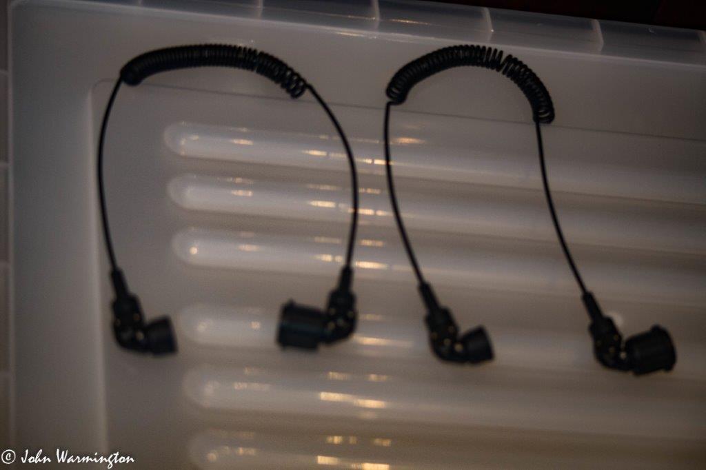

  19. Hi Pavel, I think I was wrong in the reference I gave you, because I have simple fibers (see photo) and not doubles.they were sold to me be Nauticam brand. But these are not the ones that would be advocated by Nauticam. But I think seriously that I must change them. in any case thank you very much for the help provided.
    post-62922-0-30931600-1541008150_thumb.jpegpost-62922-0-30931600-1541008150_thumb.jpeg
