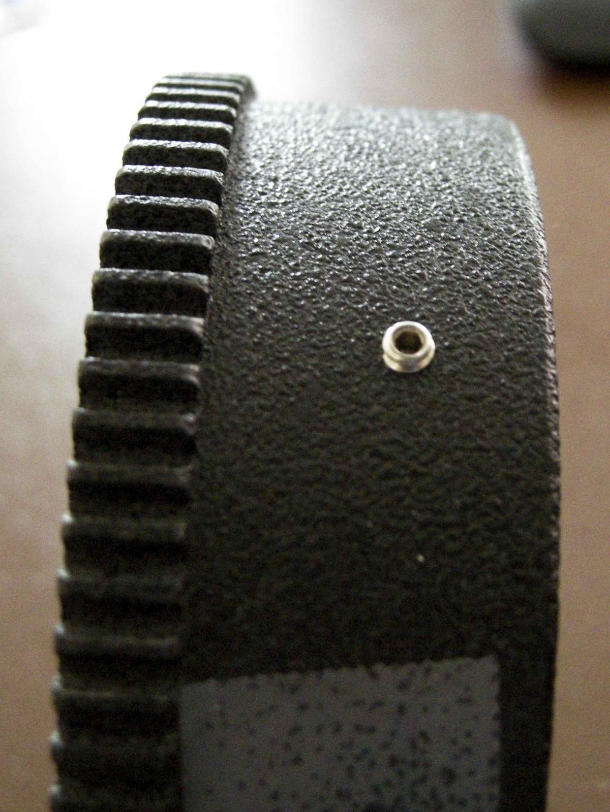

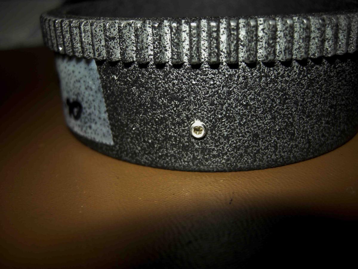

  5. Had a similar problem years ago with an Aquatica zoom ring and a Tokina 10-17 lens where the zoom ring did not fit tight enough to prevent slippage UW. I installed three small set screws 120 degrees apart on the zoom ring. I positioned them to contact the zoom ring in such a way that they met the lens rubber zoom adjustment at a solid part of the lens. It was some years ago, but I believe they were 6-32 with an allen head. I bought a 6-32 tap and handle, about $10 back then. The biggest trick is to make sure that you drill the holes for the tap the proper size. Also pick the length of the set screws so they are flush with the outer portion of the zoom ring when tightened. And make sure that the set screws are positioned such that they do not interfere with the housing gear as the ring rotates.
    I have since installed set screws on all of my zoom rings and have not had any slippage problems since.

    Interesting solution there, divengolf. Any chance of a pic showing what it looks like?

  8. Tim,
    Here's a couple pics of the zoom ring. My lens is packed for a trip to Africa, so the ring is removed. This will give you an idea of what I did.
    Harry

  10. Tim,
    Harry
    Neat! Thanks, Harry. You must have a steady hand....
