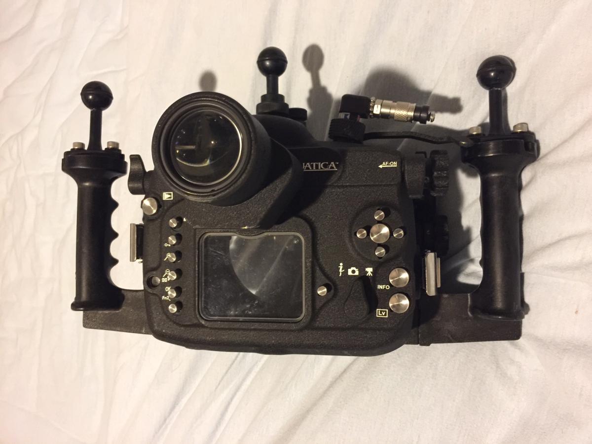

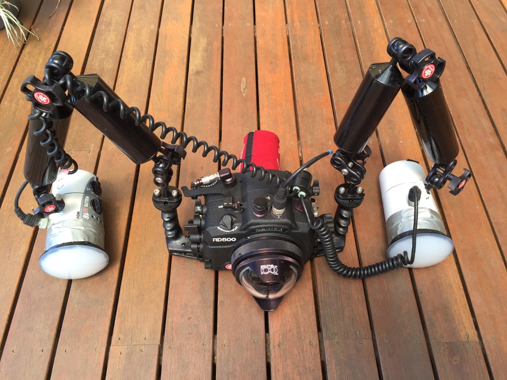

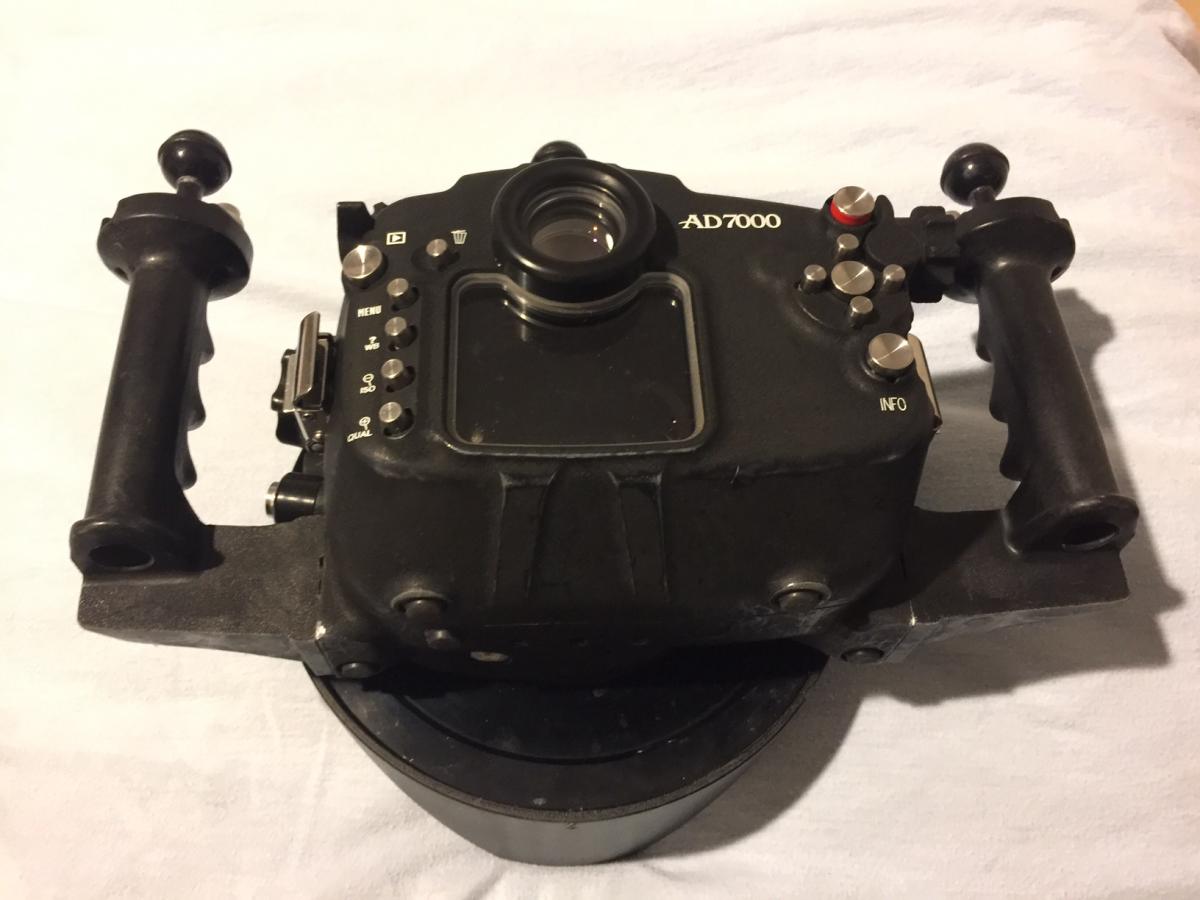

    I have been diving with the Aquatica AD500 for over a year now and it was an upgrade from previous Aquatica housings I owed (D7000 and D90). My setup has Ikelite bulkheads as I use Ikelite Ds161 strobes in manual mode. As others have stated the ergonomics on the Aquatica are great and everything is close to your hands for quick setting changes, I especailly like the ISO lever which is righ next to your right thumb. The housing grips are brillant and simply mold to your hands and there is no movement or flex in them especially when you have heavy strobes hanging off the ends of them. The latches were a little hard to get use to when I first had the housing but now its very easy once you get the nack of it.
    The housings are machined out of a block of Aluminium alloy, then anodized, and powder coated with polyester with the control buttons made out of what I believe to be stainless steel. All of which makes a housing able to with stand alot of abuse and still works and looks in good condition after many years of hard work. My Aquatica D7000 which I still have looks in great shape considering its done over 1500 dives since I have had it.
    I also like the adition of the Surveyor moisture and vacuum system as an added peace of mind and safety feature. It has saved my camera on a couple of occasions when I hadnt noticed a stray hair from my beard had found its way when setting up. Its also important to trust the system once the alarm does go never minding how well you think you have put your setup together. The constant flash of a little green light during the dive does reassure you alot.
    Corey I noticed that your Canadian and with Aquatica being based in Montreal they would most likely be able to provide quick support and service when the need arises. Which is also an important feature when looking at housings especially those of us who live on the other side of the world.
    If you have any other questions just ask,
    Regards Mark
