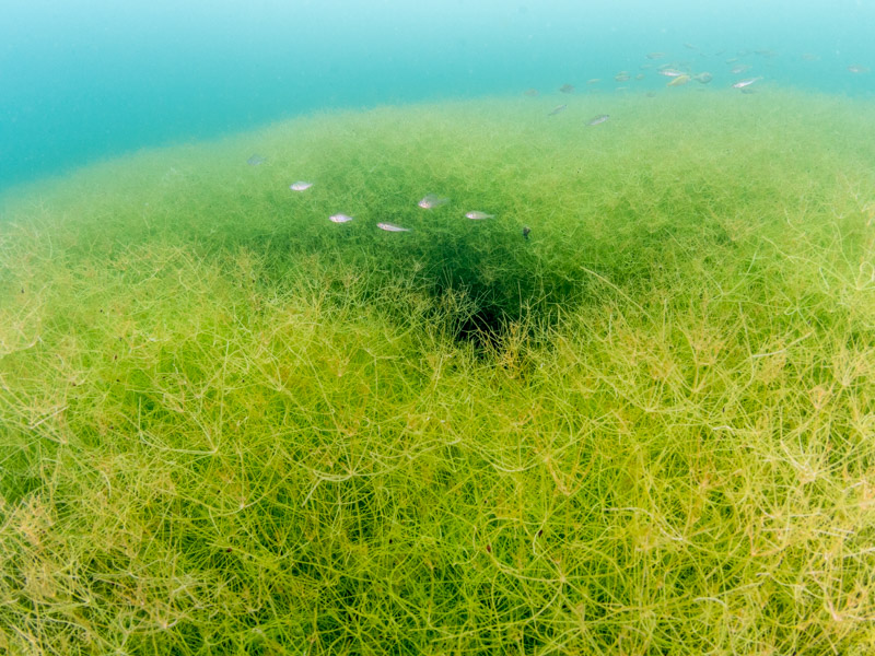

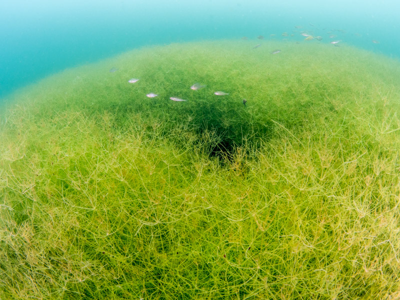

    Sample image: ISO 400, f8.0, 1/100, ambient light:
    Geometric distortion 100% corrected (vignetting corrected 100%):
    Geometric distortion 50% corrected (vignetting corrected 100%):
