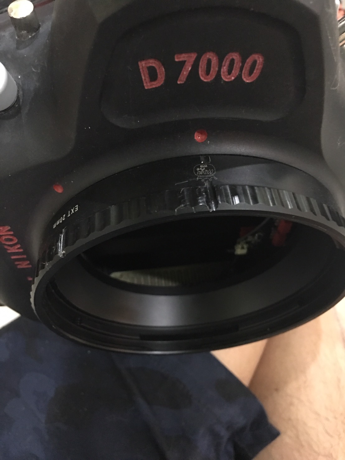

    I need help with my hugtfot d7000 and 20mm. extension port that stuck in front of the housing and cannot take it off!!. I try many ways to remove it but not work.
    Do i need any tools to remove it? or if you have any experience please share.
    Thank you in advance.
    Ta Pitt

    Thank you for your reply. I trt to put dome on and that doesn't work for this case. Actually this part was stuck in my housing for month and i worry that it wilk cause laeking and flood my housing one day. I try so many way to remove it even buy port remover from divervision (see pic below) and that doesn't help me at all. I'm leaving in Thailand so send the housing back to Belgium is quite expensive. I just curious that do people who owned hugyfot housing dosen't have this problem? Or they have but can figure out the easy way to handle it.
    If anyone have this problem and can fix it please share your way to me.

  7. Thank you all to helping me for this problem. I just finally removed it!!!!!
    By use old bladder rubber tighten around the extension port.
    But this not solve my problem last long.
    Still wonder what's wrong with my housing.
    Why this just happen to me only. Hmm curious.ed6d9553cdb209eaf4147b46a2f506f2.jpg85d95224d3331da10f841227a54afe79.jpga0d62a20fe123f4fc062b46738d0f69b.jpg
