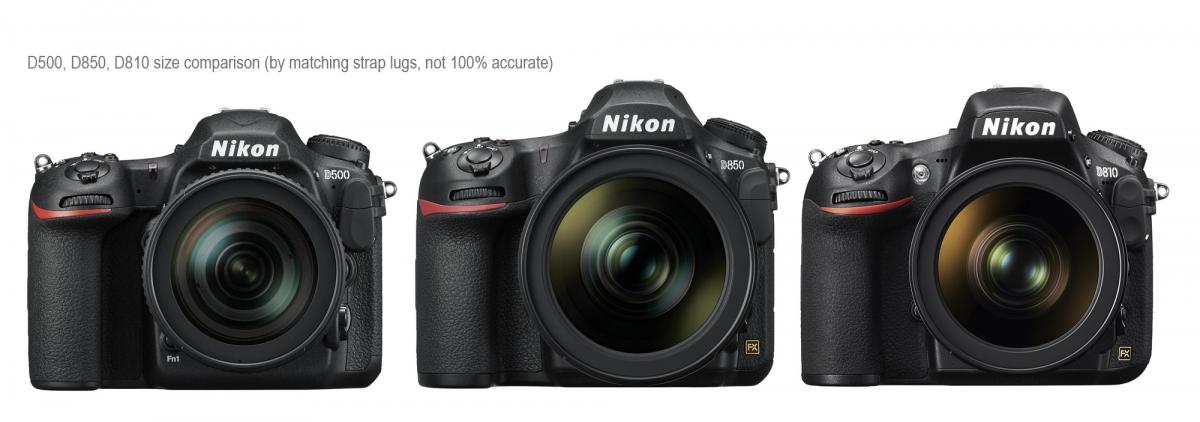

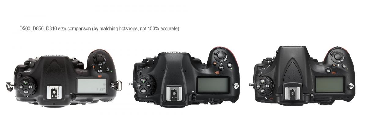

  3. Hi all,
    Nikon Rumors published some images showing size/shape comparisons..
    Sadly, it looks unlikely that it will fit in any existing housings...
    Adam
  4. Not happening. Many changes to control layout too.
  5. Sadly, I must agree.
    Early optimism dashed on the rocks of reason...
