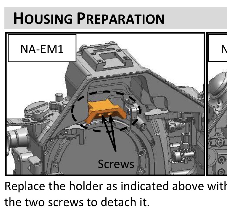

  3. Phil, thanks for the response. I guess that I'm confused because the images that I've seen of the flash well on the NA-EM1 housing show the flash wedge:

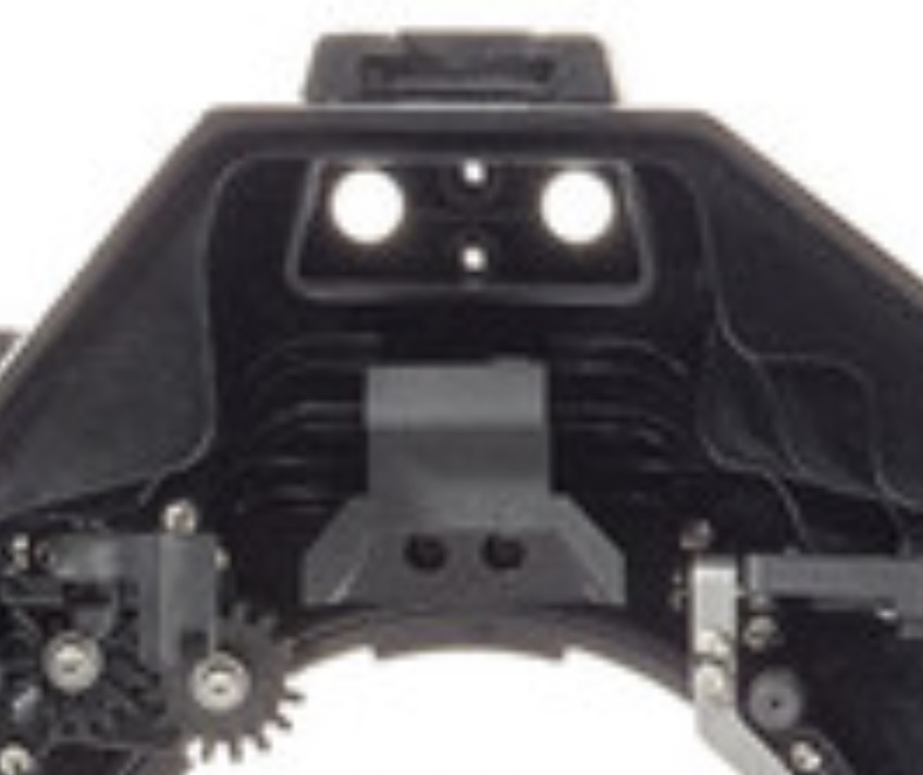

    Which looks to be the same as the NA-EM5 wedge:
    Since the instructions for using the flash trigger in the EM1 mk.I housing show removal and replacement of the wedge...
    it seemed likely that the same could be done in the EM5 mk.I housing. I was hoping that one of the many E-M5 shooters here might already have tried it.
    Thanks, again, for the feedback. If you have any thoughts on the above, please let me know.
    BTW, I apologize for the low quality image of the EM1 housing... I grabbed it off of the net, using my phone..
    ATB,
    Elliot
