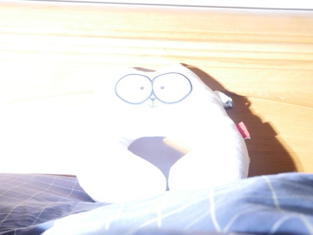

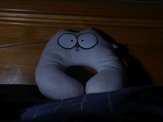

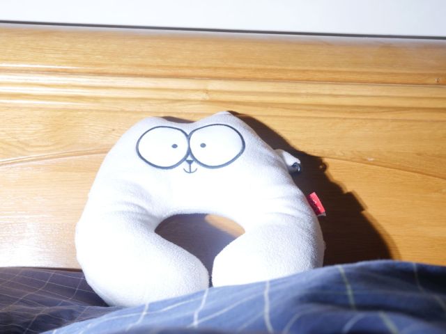

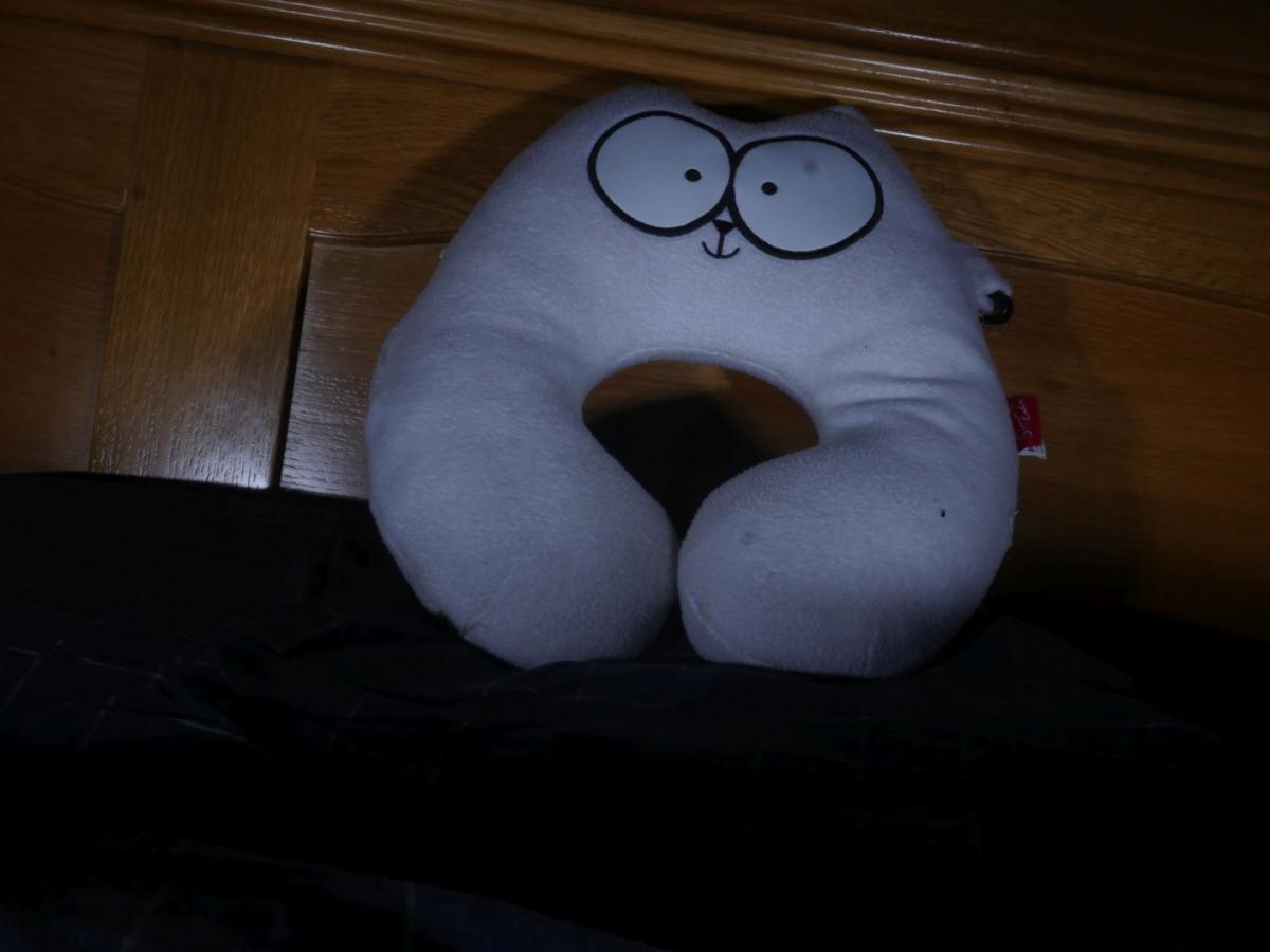

    To give you some idea....two pics atached - 2 strobes, both set to manual, power 1 (lowest). Preflash was OFF for built in strobe, and ON for trigger. Both shots done in f/22 and 1/250.

    That's an interesting bit of info....I was assuming on Manual flash is always of the same duration...little, dirty Inon secrets :)
    Ran another batch of tests, this time on f/10 and 1/125..and noticed a weird thing:
    -when ISO set to auto, built in is very bright, iso from exif shows 800, trigger is dark, iso from exif shows 200 (image 2 and 4)
    -when ISO set to 200, both built and trigger look the same, somehow mid between dark and super bright. (image 1 and 3)
    Tested brand new batteries as well, but it made no difference, same results.
    So it might be GH4 after all...though still theoretically I am not getting full brightness...i.e. built in on auto is still brightest.
    Well manual ISO might be the way then, perhaps Auto one gets somehow confused with trigger attached :D
    Hmm I am getting a feeling it's time to smack myself over the head and say "doh" :lol2: :lol2: :lol2:
