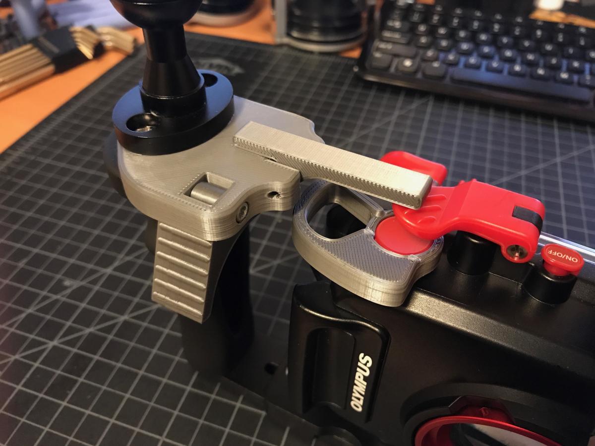

  1. After diving with the PT-058 housing and KitDive tray I had some annoyances that I wanted to fix.

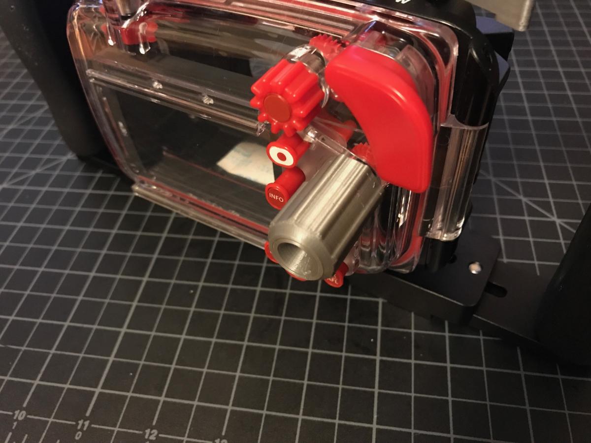

    • Camera mode knob is difficult to turn with 5mm gloves on.
    • Need camera trigger from camera tray handle
    • Zoom knob not easily accessible from tray handle
    • lens cover floats around and gets into image
    I 3D printed some mods out of PLA that have been great, I've dived with the knob and camera trigger a couple times but am excited to try out the lens holder and zoom knob.

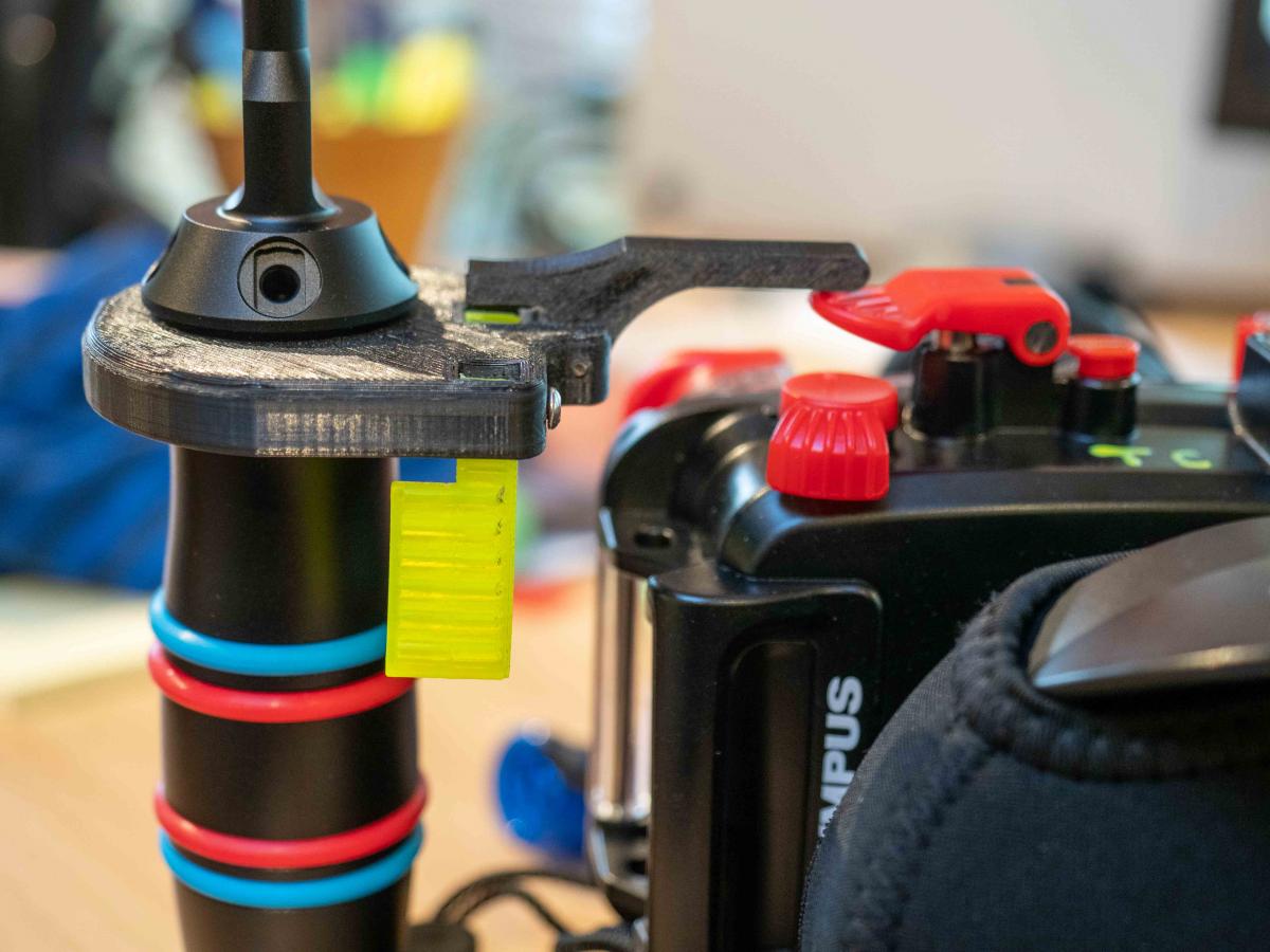

  3. The shutter trigger and lens cap holder have been working great, have gone on 40-50 dives with them. The zoom trigger I ended up getting rid of, it doesn't have good retention mechanism in the current design. I made them on my own 3D printer that I have, if you are interested message me and I could print a set for sale.
    The tray is from CamDive (Type B) that I got from Amazon: https://www.amazon.com/dp/B01D9UI2I4/ref=twister_B078CZ9NYD?_encoding=UTF8&psc=1

    The trigger has been working well though the lever arm did break once (jamming on it to hard trying to get the perfect shot :innocent: ). I printed another with 100% infill and haven't had any issues since. There is enough throw in the trigger that it's pretty easy to control half-press to focus before activating the shutter which was really helpful for timing shots. The zoom lever attachment popped off after awhile though. I ended up just getting used to reaching around to adjust zoom. While not ideal it could be epoxied on. The lens cap holder has been great with no issues. I upgraded to a larger camera system a couple months ago but probably got at least 150+ dives on the TG-5. I still plan on using the TG5 for lighter travel like for going snorkeling/free-diving.
    This trigger looks pretty nice - tempted to get it as well. But as configured in the photos, it looks like the mechanism that actually depresses the shutter will interfere with the zoom mechanism on the TG-5. You may be able to reverse how it's mounted, though. I don't own the Sony so I don't know where the zoom mechanism is. Will you have a look when you get it, and please let me know? Thanks!
    The trigger lever bottoms out just above the zoom swivel so that's why the zoom attachment goes around it to prevent any interference.
    Let me know if you're open to making more parts for the shutter and zoom mechanisms. Thanks!
    I'd be happy to share the 3d *.STL files, I've uploaded them to thingiverse here: https://www.thingiverse.com/thing:3030704

  12. Great idea and I have had a go at a similar version to work with the Weefine tray which needed a cranked arm because of where you fix to the tray.
    Had the first dive with it yesterday and it makes life much easier on the fingers. Next in sketchup is a zoom lever for it.

  13. I have been looking for a mod for the mode button which is really hard to operate with gloves. Are you planning on making any more? Would love to buy one since I don't have access to a 3D printer. :)
    Thanks!
    Amy
  14. A simple extender for the PT-058 Mode button can be made from a short length of Tygon tube, 12 mm id.  It fits tightly on the Mode button.  Four 6 mm holes drilled near the tube's top to roughen it for easy turning.
