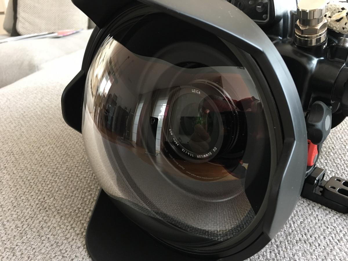

    As a replacement, I plan to use the Panasonic 12mm 1.4 Lens, either with the 180 Nauticam Optical Dome (with 85 to 120 Step-Up Knob Adapter) or alternatively with the 140mm Optical Dome for M85.
    With the 180 Dome, the lens seems to stick slightly out, but a 20mm Extension ring on the other hand looks too long. On the 140 Dome, not sure whether its the 17mm or the 20mm extension ring.

  3. Hi Richard. I got really frustrated with the Panasonic 7-14 in those nasty conditions we had during our Fiji trip. Had to pull up ISO badly to see anything! Ya the 12mm f.1.4 really is a low light stunner.
    On the 180 it sticks out about 5-6mm I'd say, not sure the photo is of any help. On the 140 cant check yet as I havent got it at hand, but I think with either the 17 or 20 mm extension ring I should get there. But the 180 would be my preferred option anyway.
    I asked Jussi from deepshots wether he can do me a focus gear for the 180 with the focus knob extension. Not so easy as the lens is quite fat. As I said before, Nauticam's N85 system reaches its limits on far too many lenses these days...
