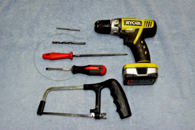

    The first photo shows a completed dive stick, and the parts​ for a second rescued and rusty ​stick​. The second ​photo is of the tools I used​ including a ​length of fishing line​; please add a hammer.​

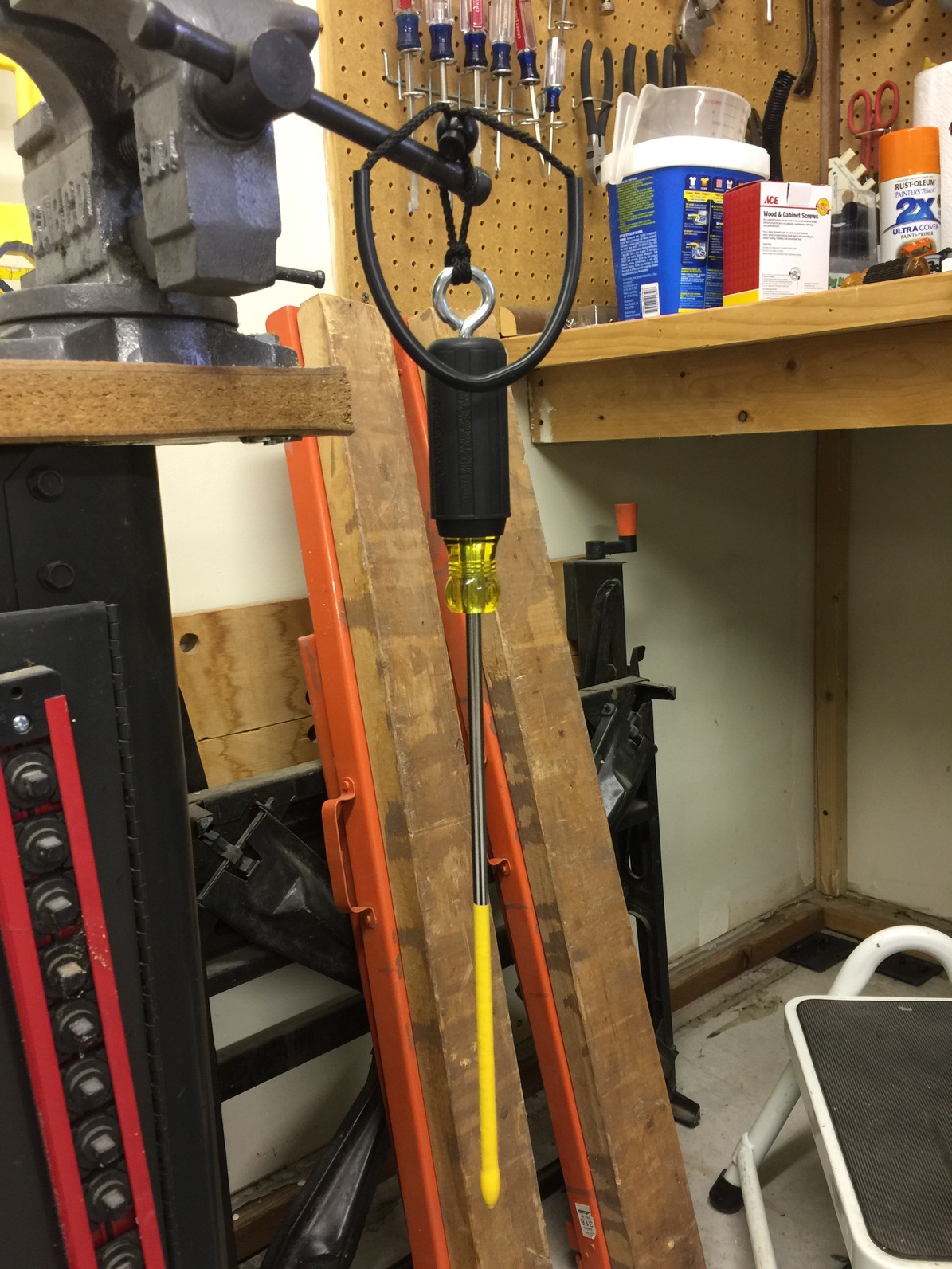

  2. My friend made a nice one from a screwdriver.
