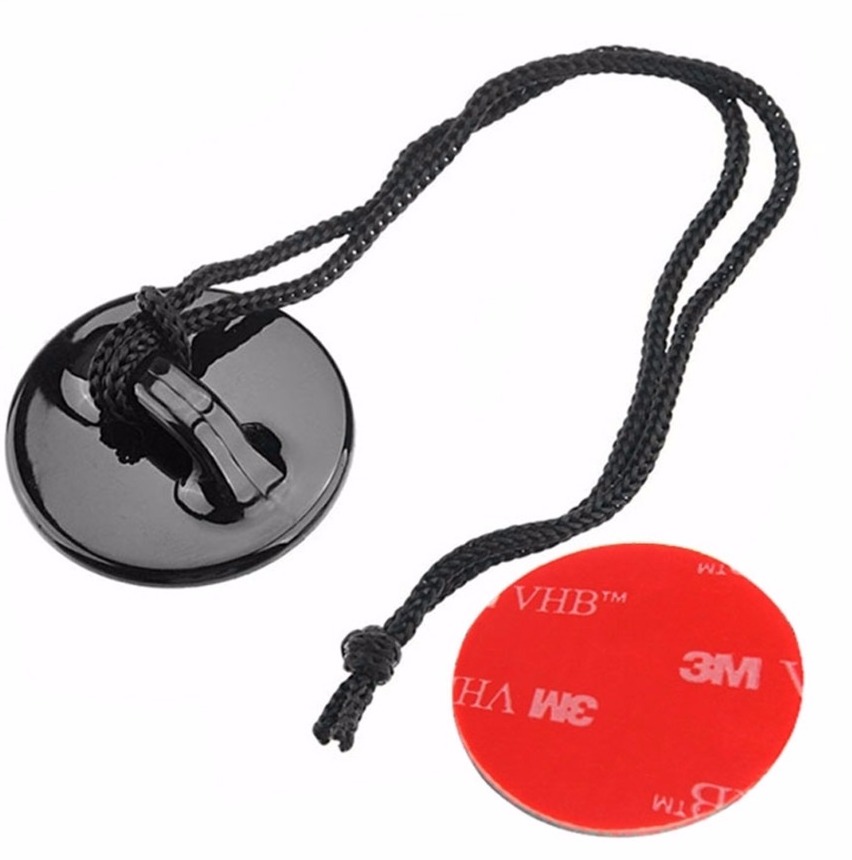

    One comment from me in regards to the hard cap. I got a pack of GoPro knock off tethers
    and stuck one on the front of the cap and fitted a spilt ring to that and then a double ender so can take on the dive and know when I had the camera to the boat guy the lens is protected.
