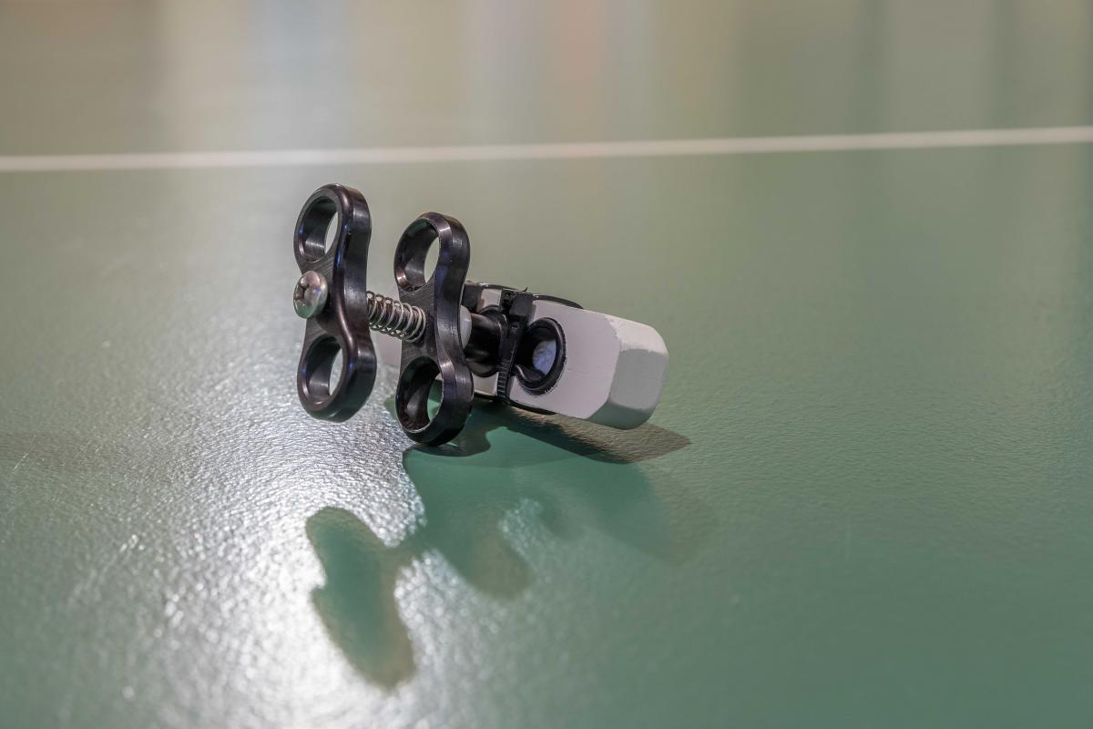

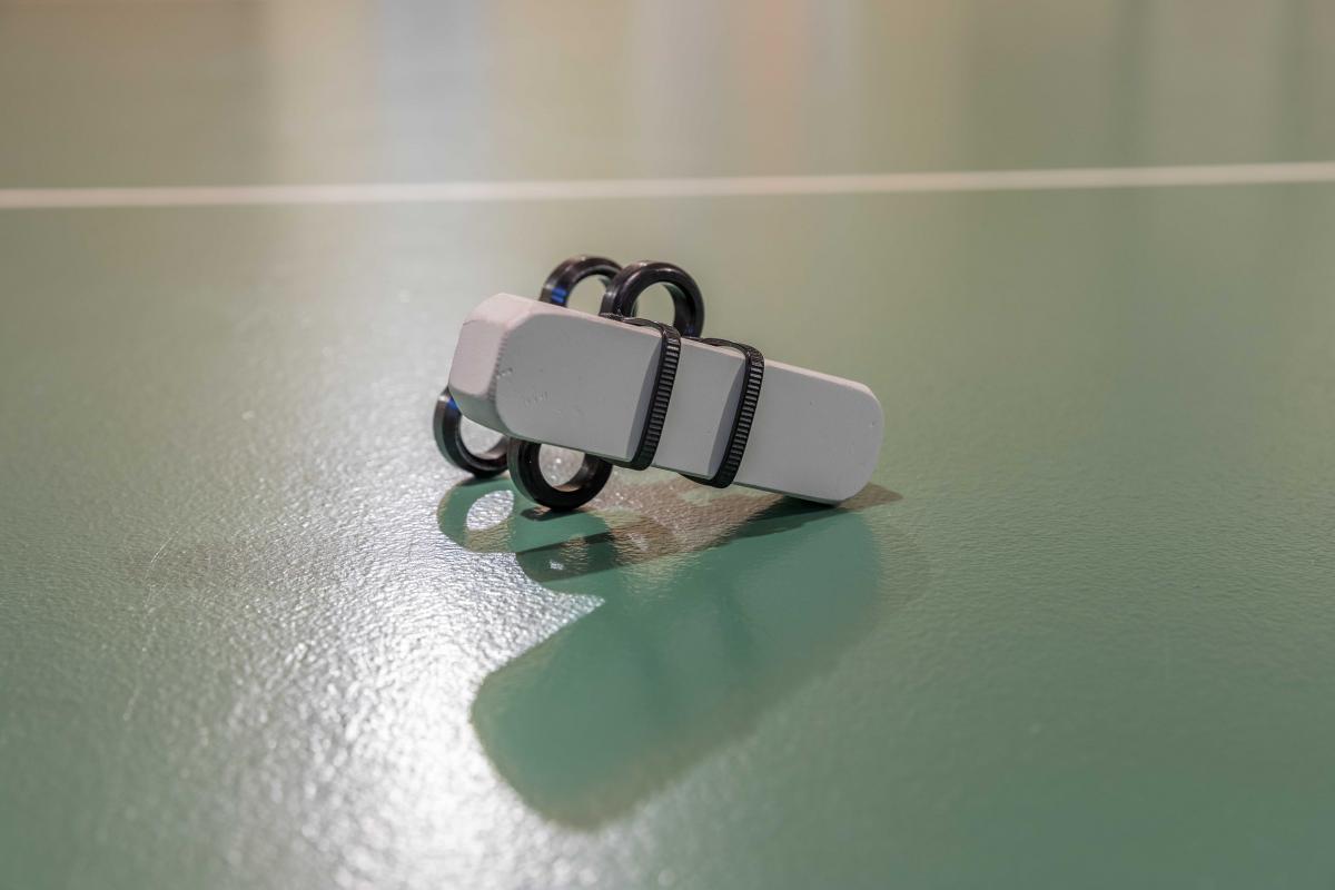

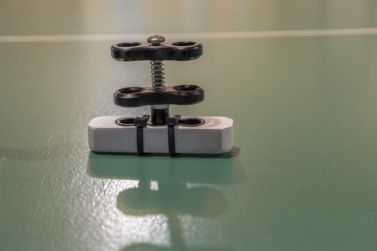

    I like my ULCS arms, but I agree that the clamps can be a bit tough to fully tighten or loosen. I made these handles quickly as a prototype (out of scrap Azek), but they work so well that I haven't improved them yet. I was planning on connecting them via SS screws in lieu of the zip ties, but I've used these for about 100 dives, and I kind of like them. I'm a Canon shooter so I don't mind the white. Nikon shooters will probably prefer black. ;)

  10. @JohnnyQuest,
    I like your solution... very simple and looks to be very effective. Thanks, for sharing.

  12. @JohnnyQuest,
    Thanks! But after looking at those photos I was embarrassed and followed my original plan with the SS hardware. Much better. :) I found little nylon finish washers that fit perfectly.
