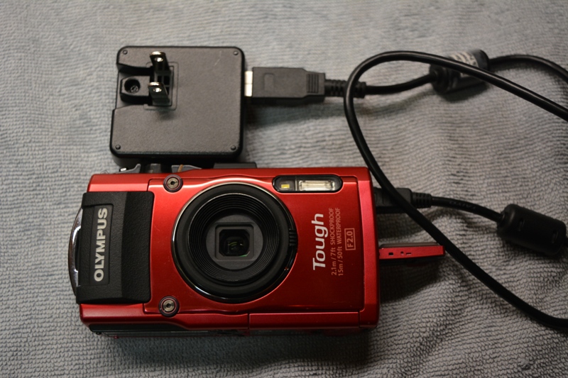

    While this was happening, and to make my life more interesting, the inside of my Tough TG-4 camera’s front lens also fogged, maybe because when I removed the battery to charge it, I left the battery/SD compartment door open.
    As a remedy, I put a pack of desiccant inside the battery compartment; then I put the TG-4 camera and three desiccant packs inside a dSLR housing and pumped a vacuum with its vacuum leak detector. I left the camera in the evacuated dSLR housing overnight, the fogging disappeared and has not recurred.
    Suggestions: To prevent fogging of the camera lens, keep the battery door closed, and use a USB cable to connect the camera to a computer to download the photos and charge the battery. The battery can also be charged with the USB cable and the USB electric charger.
