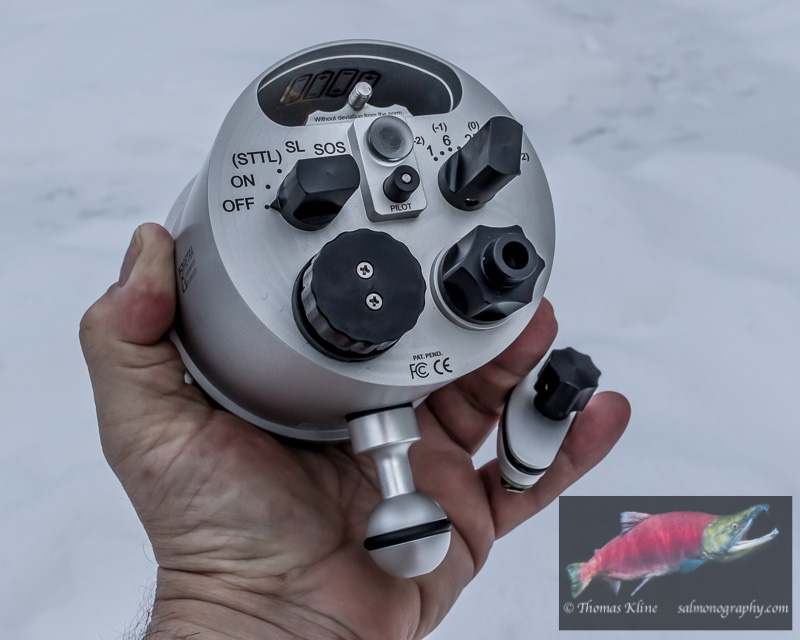

  4. I think you need to learn the Nikon F film loading technique - One had to put the back somewhere when reloading film (back was not hinged but came off along with the camera bottom). Holding between the fingers worked well. See pic with one of my Retras which just arrived. That is snow in the pic.
  5. The nice thing about cave diving is that there is rarely snow underground. That looks cold!
