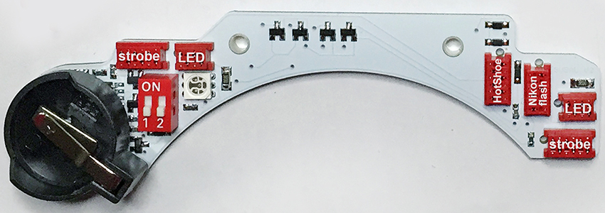

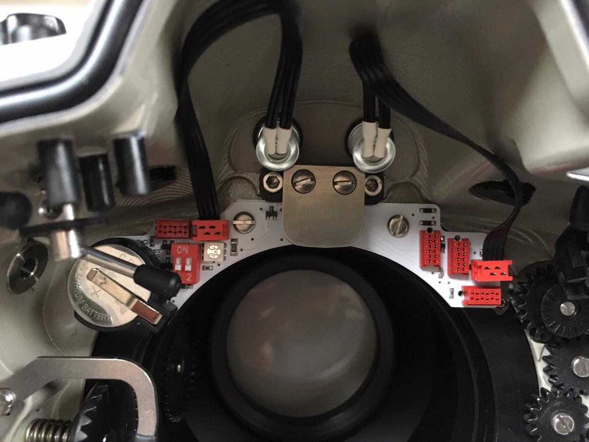

    I've just got the Subal V2 TTL board for my new ND500 housing. But the hot shoe connector isn't connected to the V2 board and there are several possible plug sockets! Anyone know which is the right one? A photo of the board is attached.
    And does anyone know the right DIP switch settings for the Inon Z240? I can't find any instruction sheet for the V2. I've emailed Subal but need a quick reply. I'm about to leave on a dive trip!

  2. I can help with information.
    Switch settings:
    - OFF, OFF = Z-240, YS-D1
    - OFF, ON = YS-D2
    - ON, ON = YS-250
    - ON, OFF = DS-161, DS-160
    Connectors:
    Edited by Pavel Kolpakov
