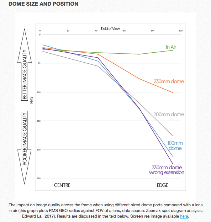

  6. These are tests from Nauticam showing the image quality achieved by lens in air and behind different dome ports underwater. All ports (when in water) significantly reduce image quality towards the edges of the frame. But the bigger the port, the less this happens. As photographers we overcome this problem by closing the aperture.
    A smaller dome port is more versatile, but for the best image quality I would not go too small on dome ports. While the <180mm domes work well with the fisheye, the optimum corner sharpness comes at f/14-f/16 range. However, with a camera with the resolution of the D850, these aperture are not best for optimum center of frame resolution (because diffraction limits the maximum resolution achievable).
    A big dome 230mm ( allows you to shoot a little more open f/11-f/13) and therefore get a better compromise between center frame and edge of frame max resolution underwater.
    The attraction of a RS-13mm fisheye is that it does not have the port effect seen in the graph above. Giving it a wider range of useable apertures (and attractively for those with high resolution cameras) the ability to achieve more center frame resolution because the impact of diffraction can be minimised.
