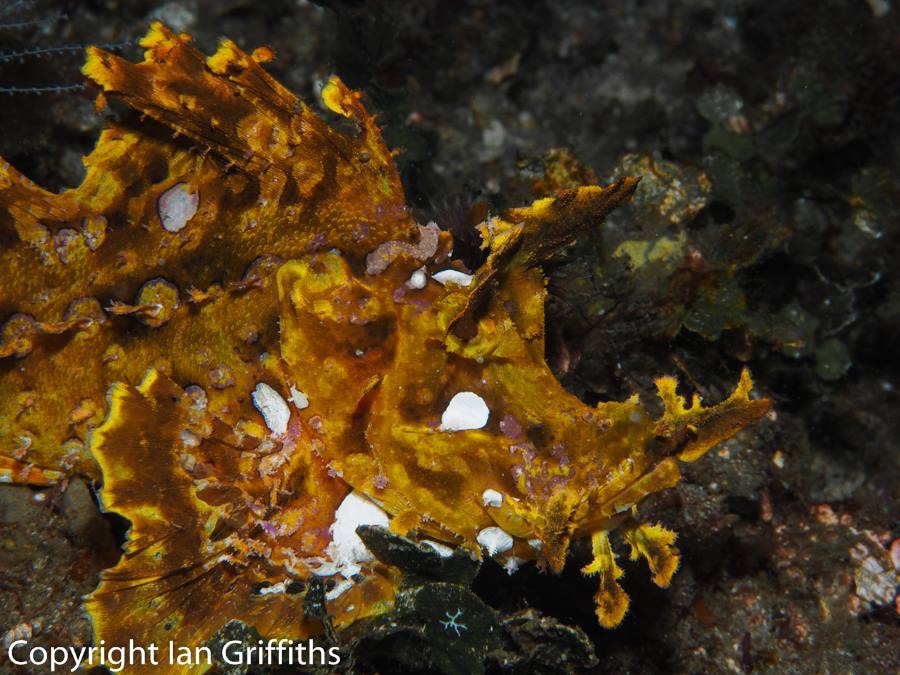

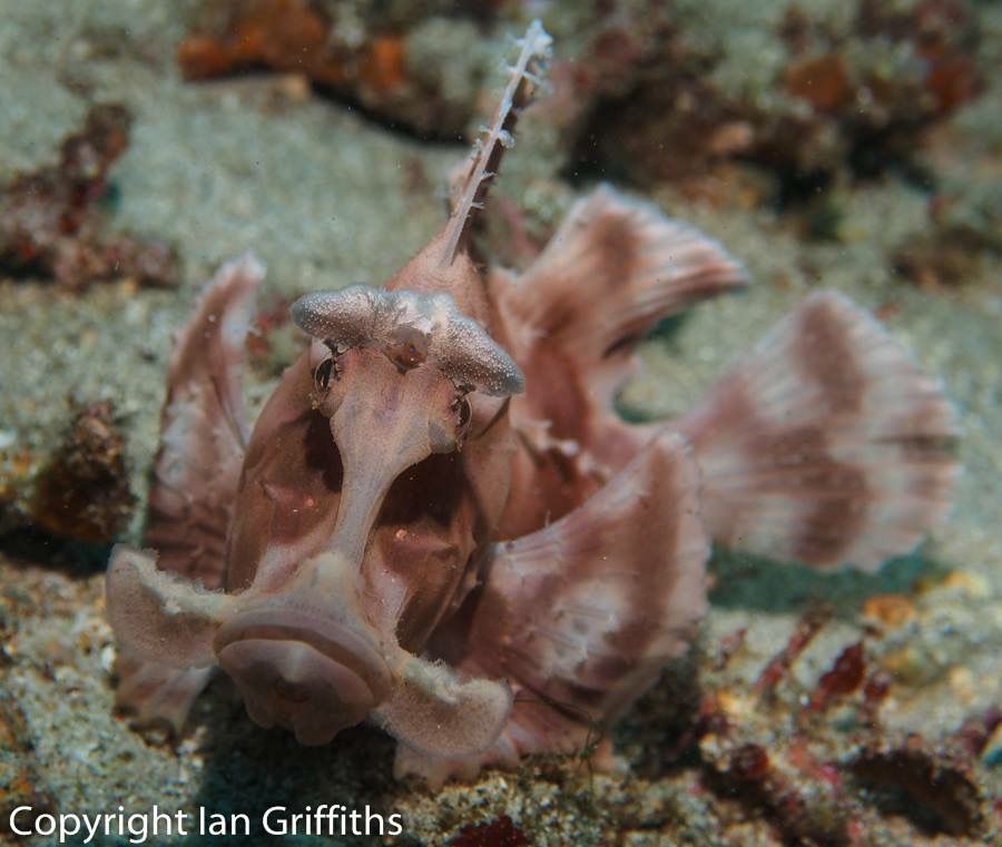

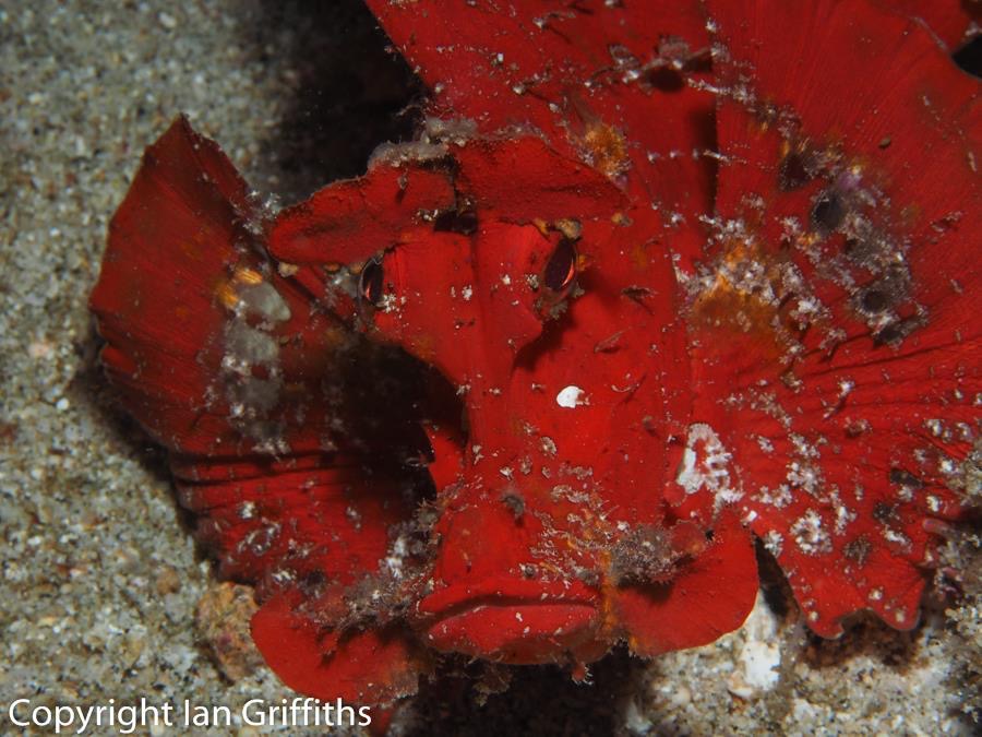

  3. I have used the 12-50 with my EM1 in normal zoom mode, electric zoom from the body in the Macro 65 port, for rhinopias in Bali and I had a macro diopter on too (Nauticam CMC) which gives 0.8 magnification at 50mm in case you see something interesting that is small.
  4. All taken with EM1 and 12-50 zoom.

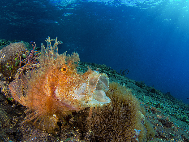

  10. If you have a Pana Fisheye and the Nauticam 3.5" dome - take it with you!
  11. I've got the WWL-1 on the 14-42; that's my CFWA fall-back.
