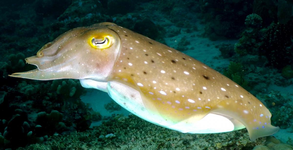

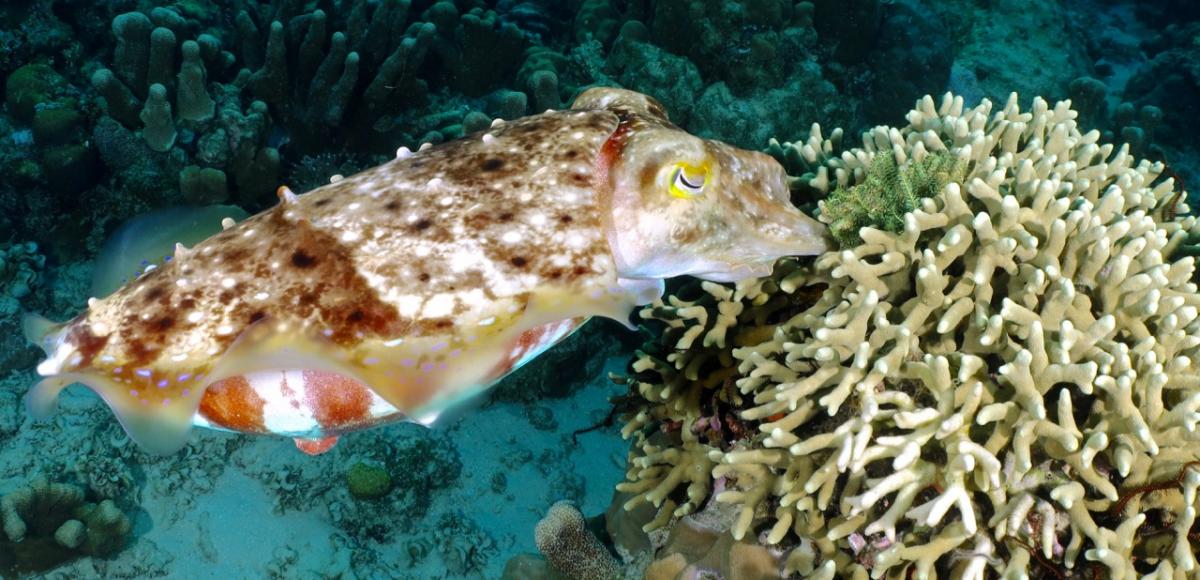

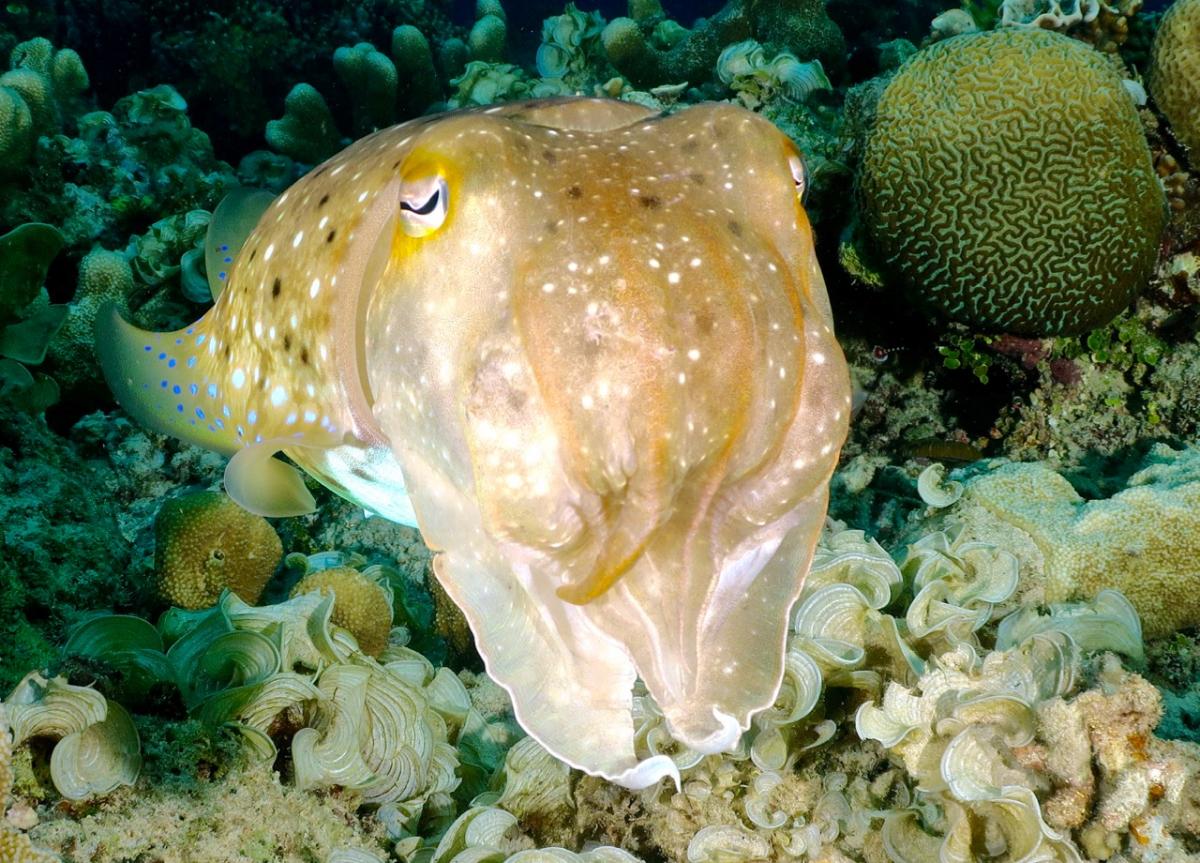

  1. Hello everyone,
    Could you please let me know why my uw photos are really awful ? I have been using canon g7x mark ii and inon s2000 strobe.
    I've dived today and took some photos with canon g7x mark II manual mode 1/100 - ISO 120 - f8 and the strobe setup was STTL, B
    My photos look like not enough lightening ? Where is my fault ? What settings are wrong ? Could someone please help me ?
    Thanks in advance.
    Edited by LAROUX

    There is some light from the strobe, the cuttlefish photo shows that, so it seems that the strobe is triggered the right way.
    Consider also that the S-2000 is a very small and not very strong strobe and will not illuminate for a longer distance,
    that may be the case of the picture of the turtle.
    1/100 - Iso 120 - f/8 was probably on the low side and the pictures is slightly underexposed.
    Try to shoot agan in automatic mode, either ISO Auto or aperture auto and lock speed at 160/sec to avoid microunsharpness.
    This should show if the sTTL is working right or not.

  12. I don't have Inon2000, but looking at your initial photos, it really looks to me like you are too far away. In some, the subject has some light, but the backgrounds, which are farther away, are showing no strobe light (just ambient).
    You also say that macro is fine.
    So my conclusion is the power from the strobe simply doesn't go as far as you would hope on those longer shots and so isn't lighting the scene.
    You could try the strobe on manual full power in a similar shot and see if it lights the scene completely, but I'm betting it won't. However, that will be the tell. If manual full power DOES light the whole scene, then you need to play with either the TTL settings or some other strobe setting until you are happy. If full power manual does NOT light the whole scene, then you either need multiple slave flashes or a bigger strobe. In the latter case somehow you need to get more light than the strobe alone can give.
  13. Ok wow...
    Please forgive my cynicism but 11 replies and no one has mentioned the primary issue here??? Apologies guys, but some of these replies are just confusing the situation.
    Laroux,
    Your ambient exposure is too bright.
    Your strobe clearly works, but the TTL circuit sees plenty of exposure from the ambient light and doesn't 'need' to add much to create a 'properly' exposed image. Dial down your ambient exposure.
    Also, as mentioned, you need to be a bit closer for best results but decent images can be had at your shooting distances.
    White balance is also way off. If your files are raw, crank up the magenta in post and you'll see a difference. For the future, start with the camera's 'Cloudy' white balance (usually a cloud symbol).
    Plan a dive to sit in one spot for 15+mins and experiment with exposure and flash settings. Set everything to manual and play around. Find what works for a given subject (even just a rock...) then switch to TTL and see if you can replicate it.
    Chris
