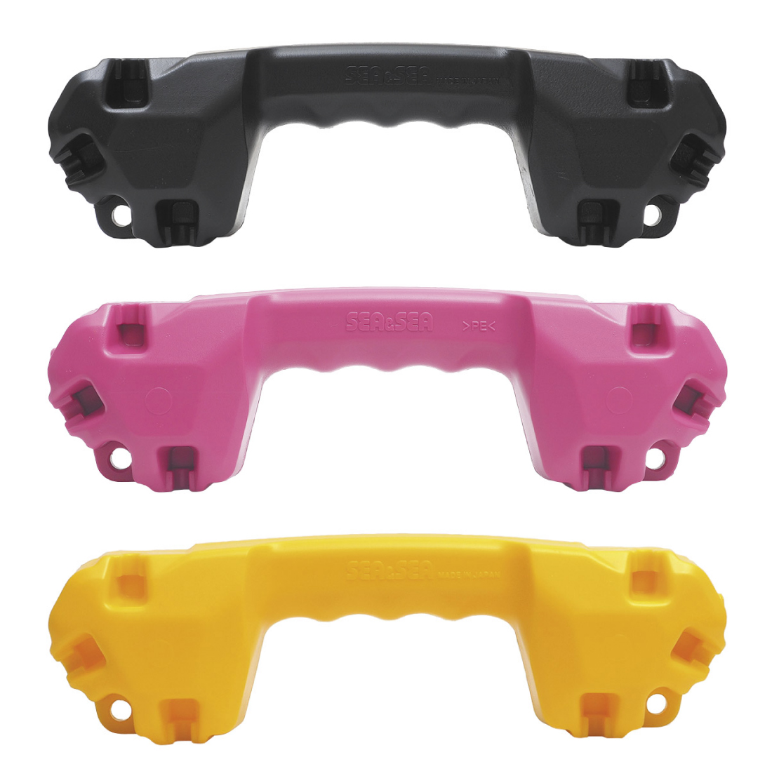

    I was searching online for some options on long arms for WA and for whatever reason
    This came up in my search:
    http://www.seaandsea.jp/products/digital_slr/accessory/024.html#46124
    Yes, looks a bit silly (someone no doubt gonna try and take a call on it...) but it did get my thinking....
    The yellow variant
    is perfect for big rigs where you want to hand off your equipment to boat handlers and I'm always trying to point to a part they can take it from me with, with this handle, its large, bright and can't be missed.
    Before I spend £150 on one (yes crazy price eh) - wondering if anyone is using one, had one etc?

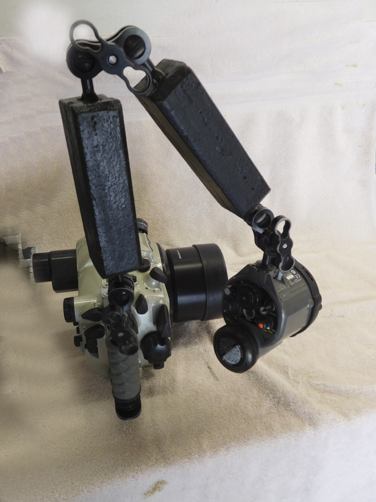

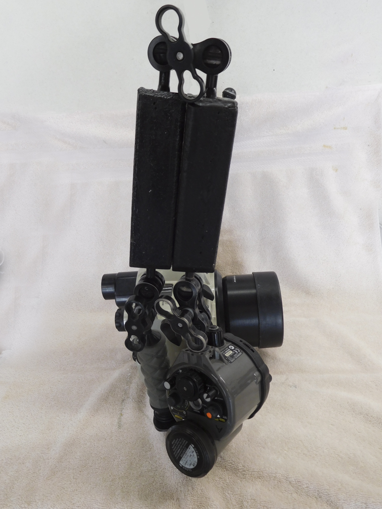

  14. Hand made from Divinycell foam.
    Folds flat with standard ultralite clamps.
    Cut to neural float Subal/NikonD500/2xInon 240z strobes.
    Cost - $US20, less clamps..post-6133-0-19874700-1526354342_thumb.jpgpost-6133-0-60116000-1526354415_thumb.jpg
