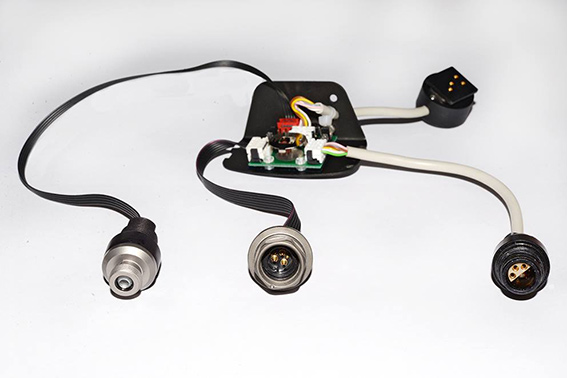

  2. Hi Marko,
    You can use UWTechnics #11035 Optoelectronic TTL-Converter, which supports INON and a pair of SEACAM strobes. Installation is under the standard metal plate in SEACAM housing. Product supports SEACAM standard bulkhead connectors and HotShoe cable.
    Possible to use S6 or N5 bulkheads. Optical bulkhead is also suggested for that setup.
    Adam Hanlon uses that TTL-Converter in D800 SEACAM housing. You can ask him to share the experience.

  4. Just to make some calculations including strobe price and optical cables + bulkheads...
    Optical bulkheads - UWTechnics #91307. It has Nauticam style optical connector, Subal-M14 screw mount and built-in LED.
    Optical fiber cables - better use Nauticam #26216.
    TTL-Converter supports the following strobes: Inon Z-330, Z-240, Ikelite DS161, DS-160, Sea&Sea YS-250, YS-D1, YS-D2, + a pair of Seacam Seaflash strobes.
    The system configuration can be assembled in different ways. For example, the one i tested (S6 + N5 + Optical):
    Edited by Pavel Kolpakov

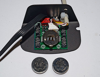

    Hi,
    Just to check, does this board support 2x optical bulkhead? I see red connector connecting optical bulkhead, but details so small, I cant see if this red connector on the PCB is double for two optical bulkheads?
    Thanks,
    Marko
  6. Just to check, does this board support 2x optical bulkhead? I see red connector connecting optical bulkhead, but details so small, I cant see if this red connector on the PCB is double for two optical bulkheads?
    Yes, it supports 2 optical bulkheads.
