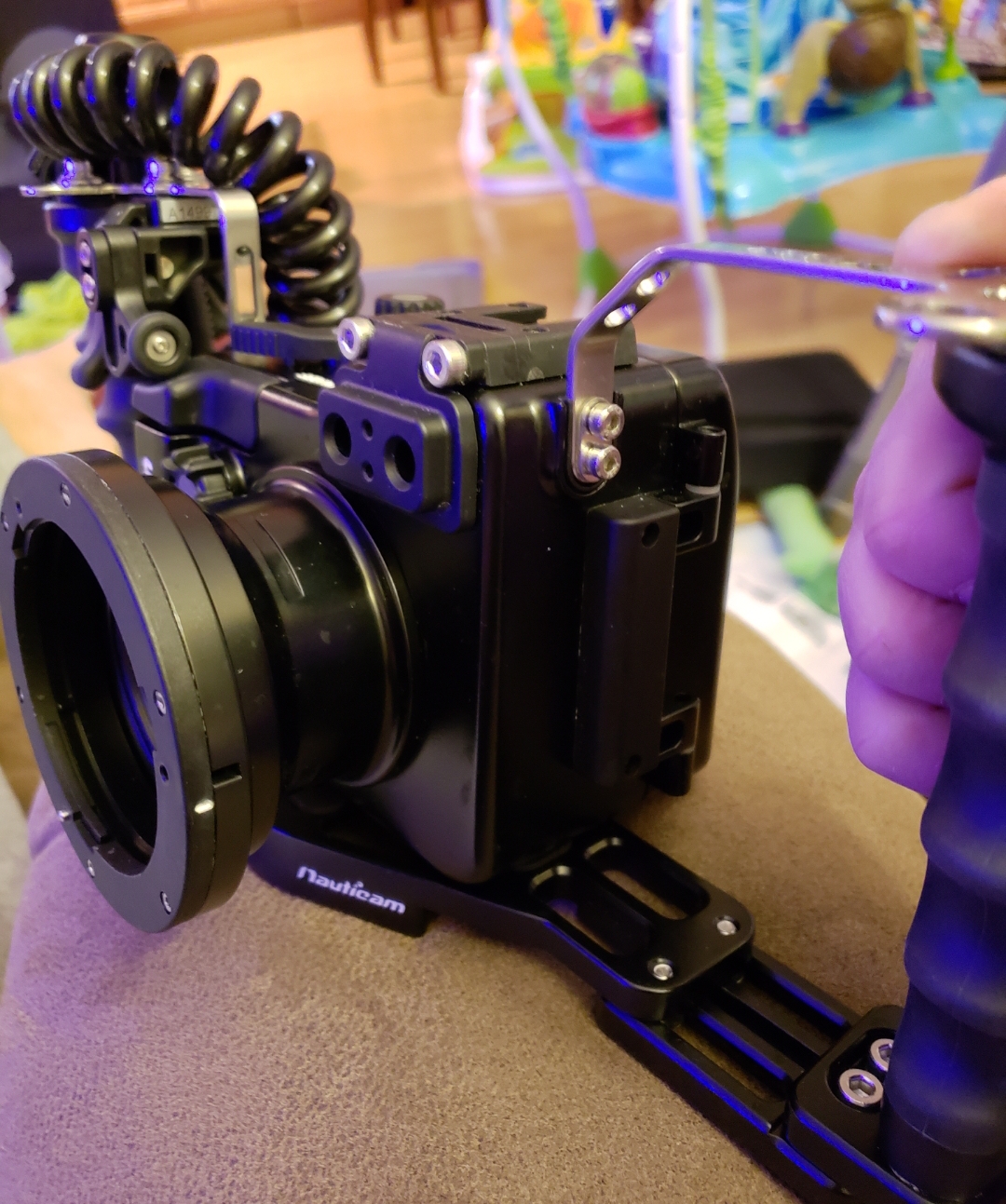

  9. Here it is I had double checked back on interceptors blog as well before I questioned it. I was able to return the bulkhead
  10. Here it is I had double checked back on interceptors blog as well before I questioned it. I was able to return the bulkhead
    Your housing doesn’t have the hole because this was intended for the strobe bulkhead not the vacuum
    That solution didn’t work and Nauticam must jave redesigned the housing to remove it entirely and make it cheaper
    So your housing is one of the newer ones
