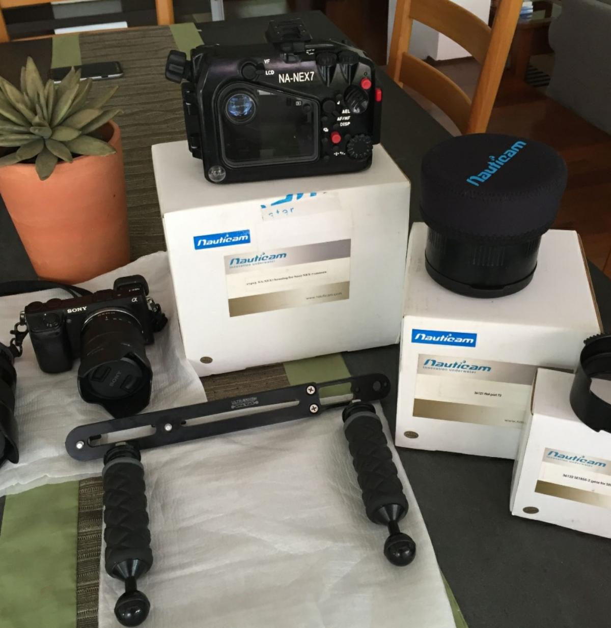

    Recently, I bought a setup, second hand.
    It is a Sony Nex 7 with nauticam Na nex 7 housing and a port that fits the default lens the camera came with.
    I wanna do macro and I would love to buy a macro lens however, I have no freaking clue what is compatible with what.
    How do i know what is compatible with my housing? I would prefer a wetlens or something attachable to the housing instead of the camera
    Cheers~

  3. Nauticam has full port charts on their website. It looks like you have 36121 N85 Flat Port 72 - you can buy 25104 M67 Flip diopter holder for 36121, plus either CMC-1 or CMC-2 diopters.

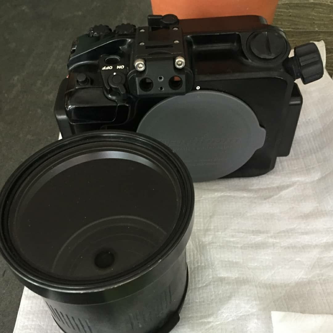

    Looking at the port you currently have, you can't add an additional macro diopter to it as there is no threads on it. Which lenses do you have? Just the one? You may need a second "macro" lens and port to achieve what you are after
  5. Looking at the port you currently have, you can't add an additional macro diopter to it as there is no threads on it.
    Nauticam makes a special flip holder that attaches 67mm lenses to this port. Of course, it being Nauticam, the holder costs $300.

    Wet lenses are normally used to get greater magnification than what the lens can provide alone. As stated your port has no thread to add a wet lens, but Nauitcam sells a flip holder for that port. They also sell a dome port so you could get reasonably wide with the standard lens and a flip holder to go with it to allow macro. The problem is that flat ports magnify the image reducing the field of view and introduce chromatic aberration to the edges if you shoot wide through a flat port. But anything around the 18-55 standard lens is a compromise. If you have the budget a dedicated macro lens will take nicer images and be easier to use. Same with wide angle a dedicated wide lens in the right size dome will produce better images and get much wider.

    Yep it's all super expensive for UW photo gear , in your case you can't use a generic on that port as it has no threads. The standard way of attaching a closeup lens is through m67 filter threads.and that's what most flip holders use.

    I don't think an M67 to M67 holder will work with this port, as it doesn't actually have 67mm threading - the Nauticam holder seems to clamp onto the port rather than screw into it. There are ways to do UW photography on a limited budget, but the words 'Nauticam' and 'limited budget' do not mix.
