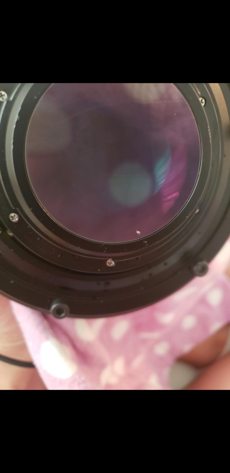

  1. Anybody know if this can be fixed on my inon uwl h100 lens... bummer it got scratched
  2. Hi,
    this looks like a coated lens, so no polishing! Otherwise you get a "cloudy" surface....
    You can only try to find the same lens with a scratched front lens, and then change the element.
    Have done that with a Inon UFL-165AD with the rear element.
    Regards,
    Wolfgang

  6. The scratch is really close to the edge of the lens. If you manage to align the scratch with the top center or lower center position of the lens into the housing most probably you can get the scratch out of the field of view of the sensor and if so it does not mess with the pictures
  7. The scratch is really close to the edge of the lens. If you manage to align the scratch with the top center or lower center position of the lens into the housing most probably you can get the scratch out of the field of view of the sensor and if so it does not mess with the pictures[/quo
    Thanks for the input I will give that a try I was trying to find it on some photos but will try again once I'm home from my dive trip

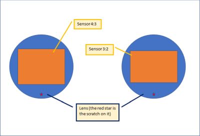

  8. You might be able to get the scratch out of field of view (see scheme)
    Edited by pbalves
  9. To do what the previous poster says check that you dont see it in the fov
    if you do undo the plastic LD part with an allen key and rotate one or two positions then reset
