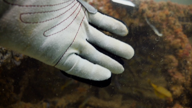

    I am quite pleased with the camera ability to produce such good color rendition when white balanced on a gray card with a red filter. My gray gloves which are a shade darker than the 10% gray card produced more pleasing colors and needed little or no color grading in post beside exposure adjustment.

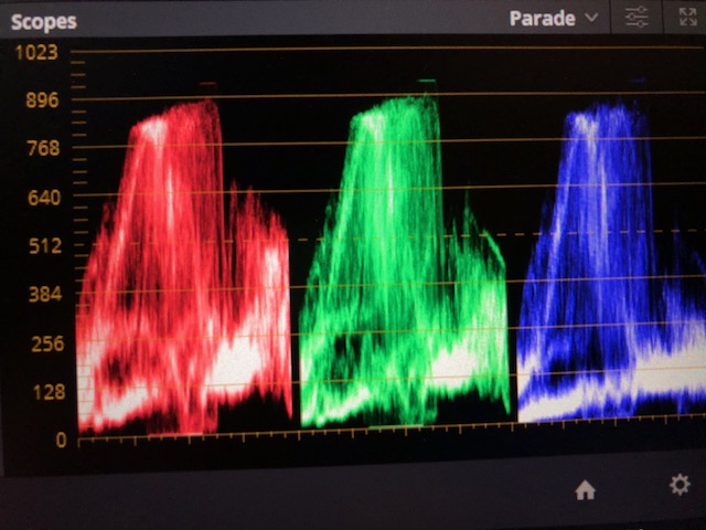

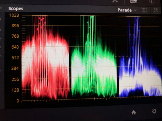

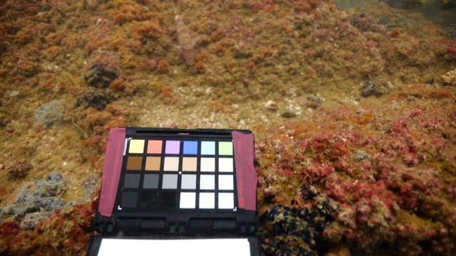

    Hi,
    I am certain you will like the GH5s especially if you are shooting in ambient light. Please share with us your findings.
    Let me make a confession, it is my first time to use a red filter and I have never been a fan :) As for the colors having a red tint (not to my liking), I think this is how the camera saw them after being MWB with the red filter. I had two consecutive dives at two wrecks with similar depths and approximately 300m apart: a barge which is an old wreck starting form 00:28-01:34 and the Car Cemetery which is few years old starting 01:35-4:50. Both dives were MWB the same way. I know the use of a filter is a debatable subject and there are situations like in the shallows where they are not needed. Actually, I think it is the visibility and the availability of the ambient light are both more of determining factors rather than the depth.
    Let me share some files that might shed more light :). These are un-edited files.
    in order: Glove, Glove RGB parade, chart, chart RGB parade
