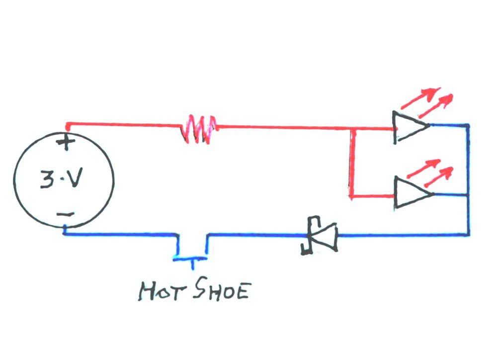

    Also, if one shoots Manual, one can build a simple LED trigger for less than $10 (2, 3).
    This LED Flash Trigger has a hot shoe plug, a 3 V coin 2032 battery and holder, a 1 Ohm resistor, two deep red 5 mm LEDs, and a 6 V Shottky diode to prevent "ringing". One can make this trigger for under $10, it is a simple version of the Subal LED strobe manual trigger.

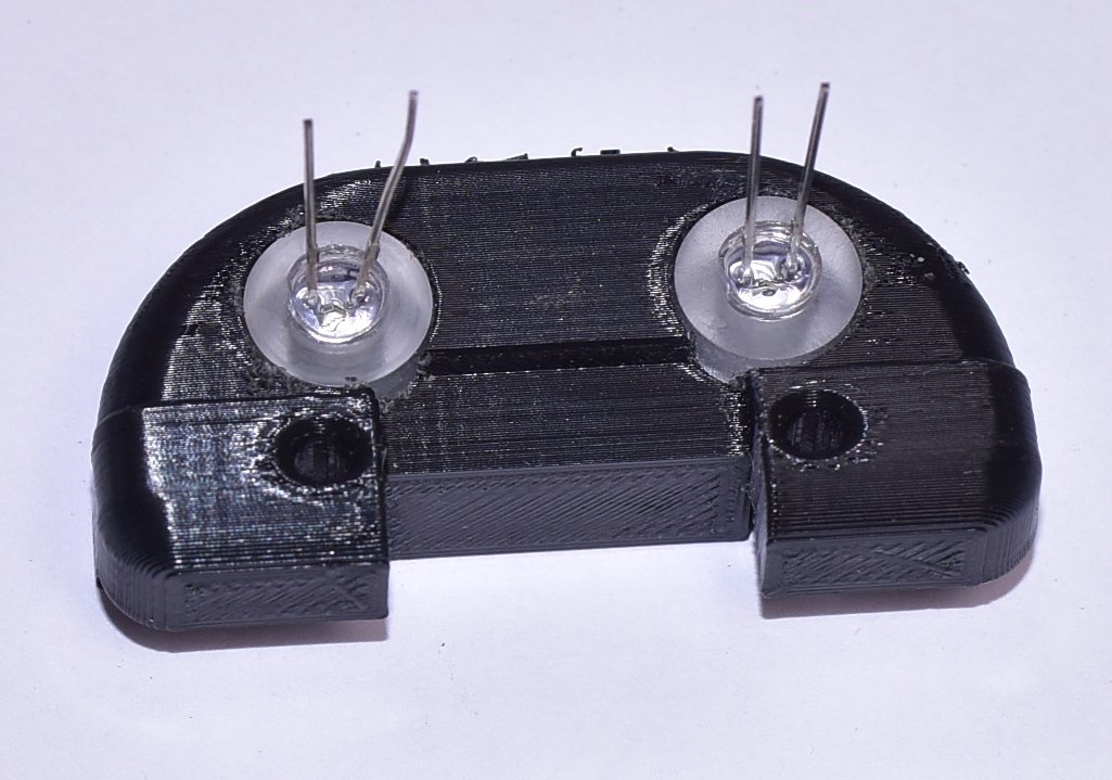

     A retainer can be made of plastic to hold the LEDs in place (4).
    3D printed LED Retainer
