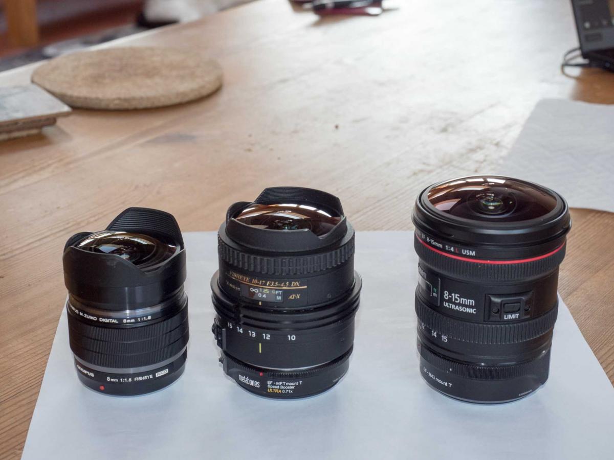

    First a size comparison of both lenses with the Zuiko 8mm Pro prime fisheye:
    From left to right: Zuiko 8mm 1.8 Pro fisheye, Tokina 10-17mm 3.5-4.5 with Metabones 0.71x speedbooster and Canon 8-15mm 4.0 with Metabones 1x smart adapter.
    It is obvious that the idea of smart little equipment is of course best realized by the native zuiko lens, but on the other hand good quality wideangle ports and wet lenses are also voluminous. In addition an may have the impression that both lenses were designed for use on the MFT 2x crop sensor, the Canon with 1x adapter offering diagonal angles of view between 170o - 85o, starting with a diagonal angle of view similar to the Zuiko at the shortest focal length of 8mm and reaching into the domain of rectilinear WA lenses @15mm (same angle of view as a 12mm rectilinear lens). In comparison with a Full Frame camera, the type of camera the Canon 8-15mm has been designed for, the Zoom allows to switch from circular fisheye to diagonal fisheye, the range inbetween remains practically unusable...
