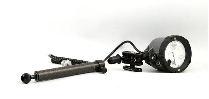

    I use a Carbonarm Quick Release arm for the strobe I use with my LSD. Lets me release/attach the strobe without having to play with the clamp:
    https://www.carbonarm.com/en/quick-release/48-arm-with-quick-release-24cm-0806808286321.html
